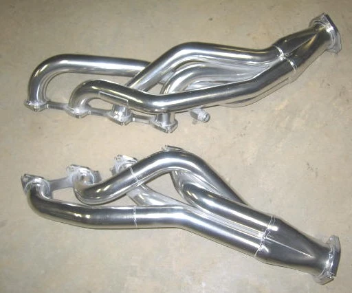

I went with a set of Kooks custom long tubes with the Jet-Hot Ceramic Coating for mine. They're hands down the "best of the best" (and I have the $1,300.00 bill of sale to prove it ).
My set up consists of a blown 4.6L with heavily ported heads and all other breathing mods, so it's worth it for me, but I wouldn't bother at all on a stock or even mild bolt-on car. For the few horse you gain, it's not worth the price tag or the headache of installing them. Just go with the mid-pipe and Cat-Back like others have stated unless you're absolute priority is to squeeze every little horsepower out of your combination and you've got a disposable income.
