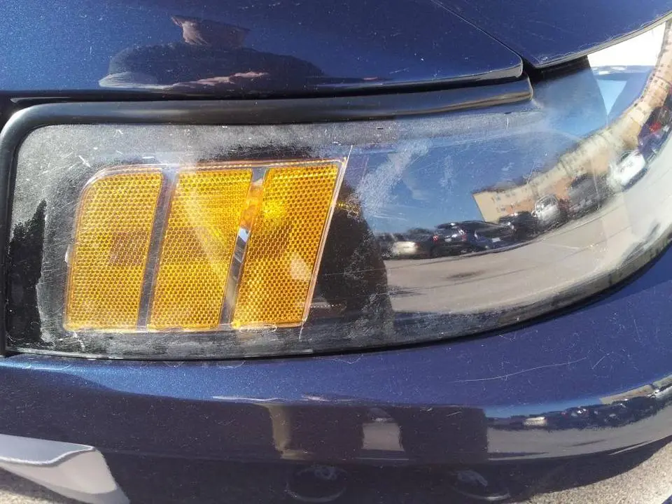

Hey guys my headlights on my Mustang are beginning to look like crap. Around the edges on the passenger side it looks like someone started sanding on the headlight and the driver side one is not as bad but its starting to get worse. I bought these headlights new 3.5 years ago and I cant believe how fast they are deteriorating on me. Ive tried some products from Advance auto parts like this Blue Magic headlight cleaner and the polish.

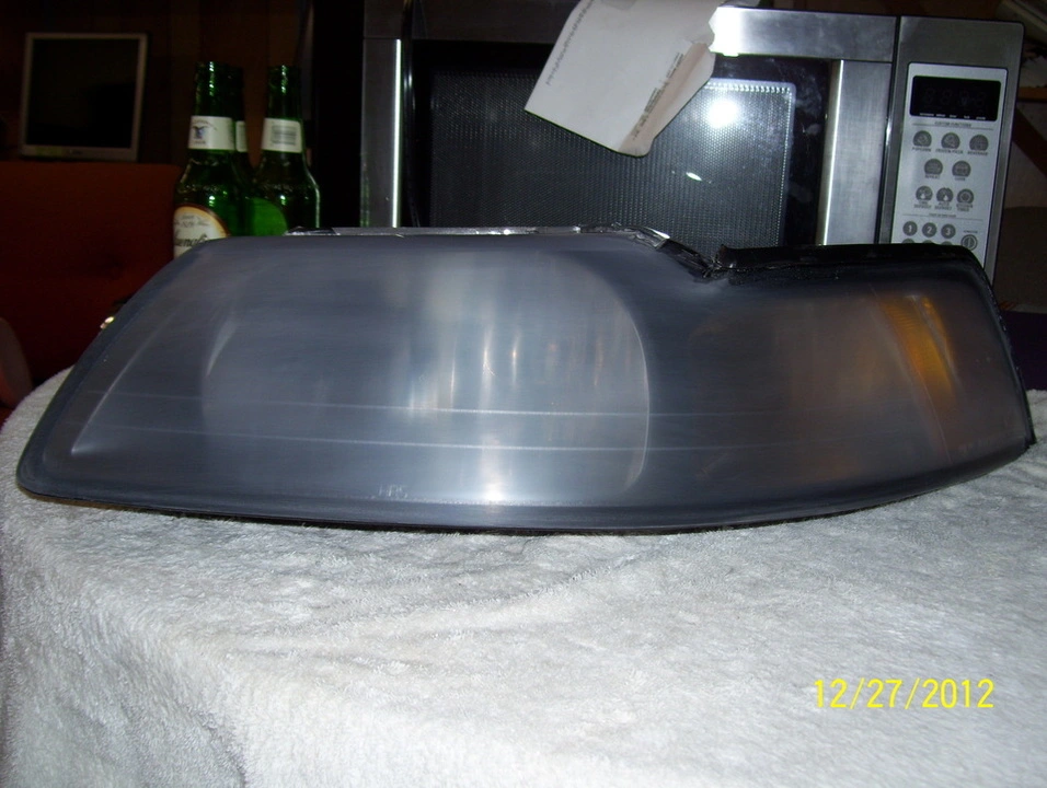

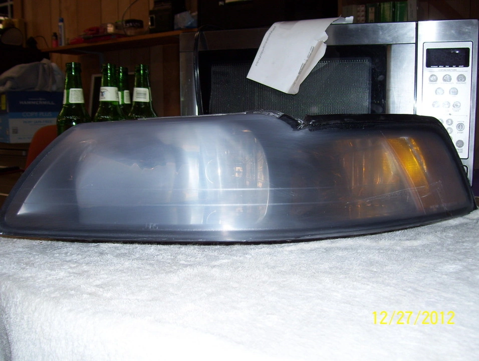

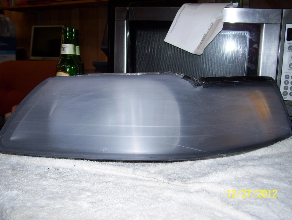

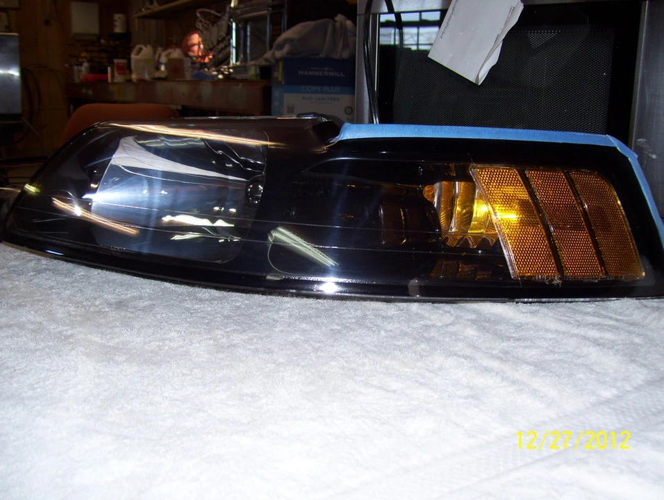

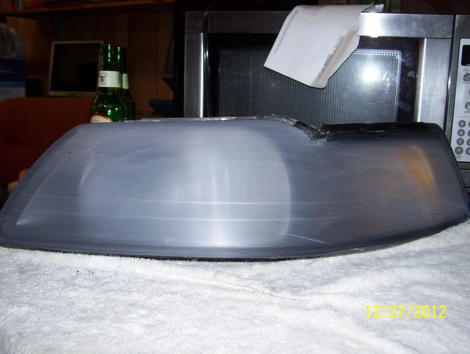

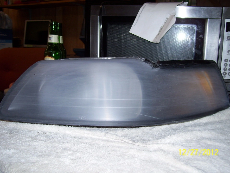

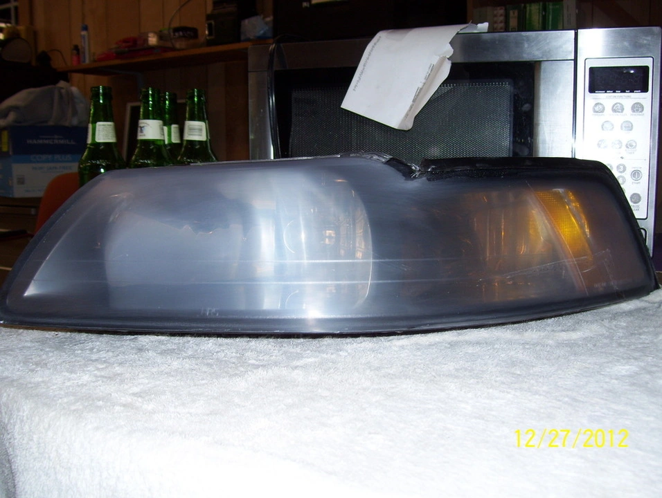

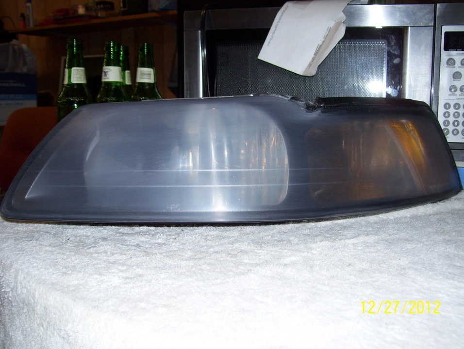

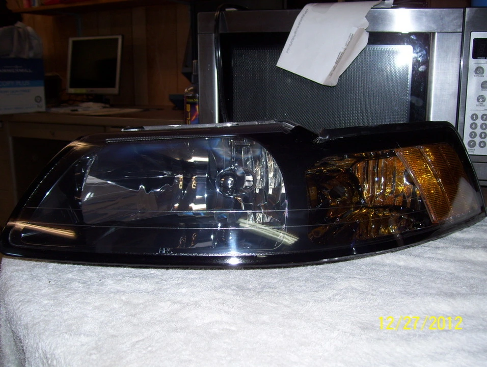

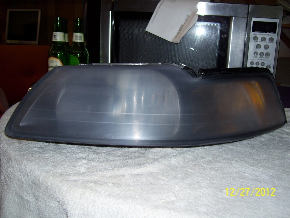

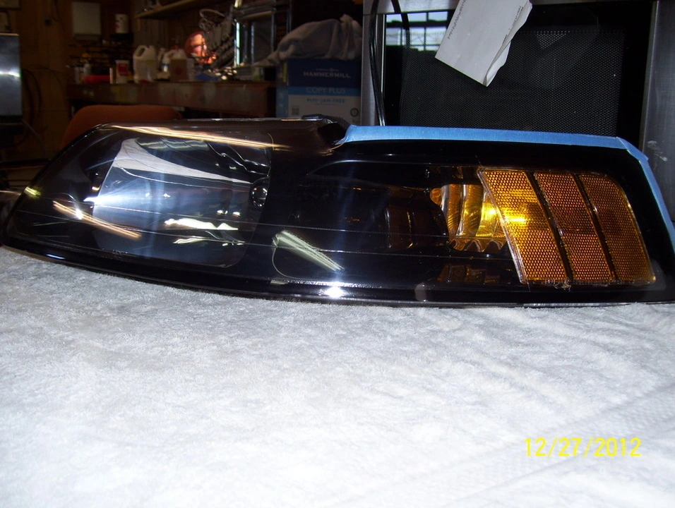

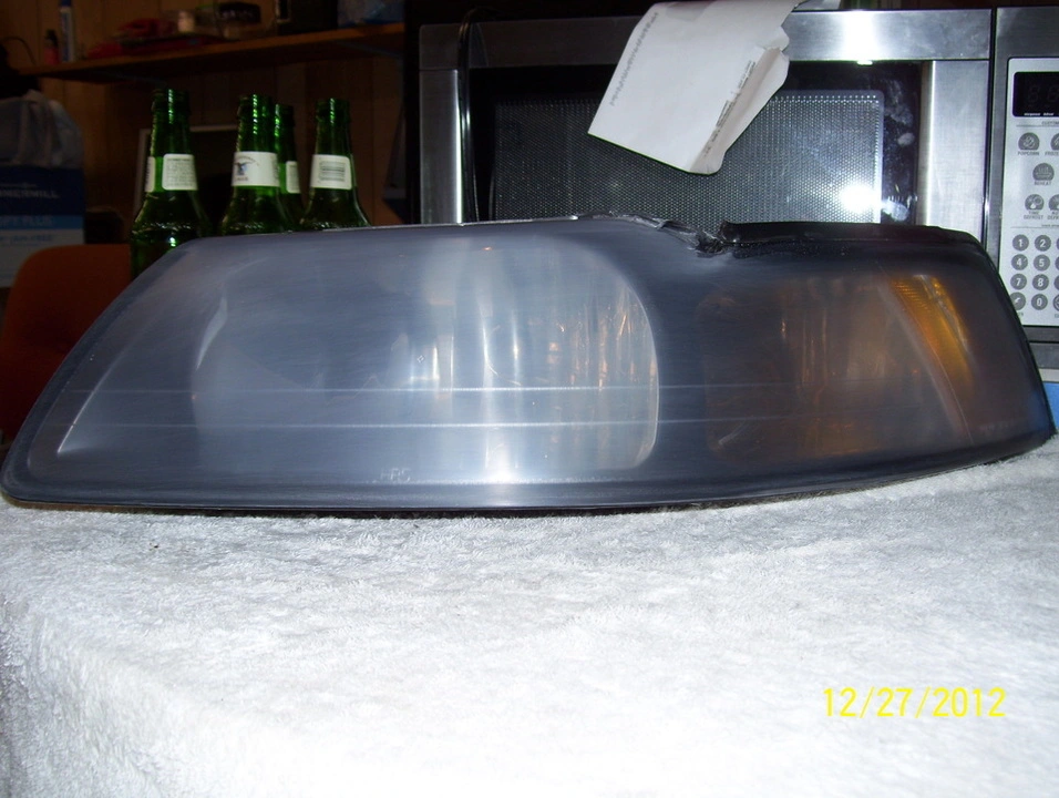

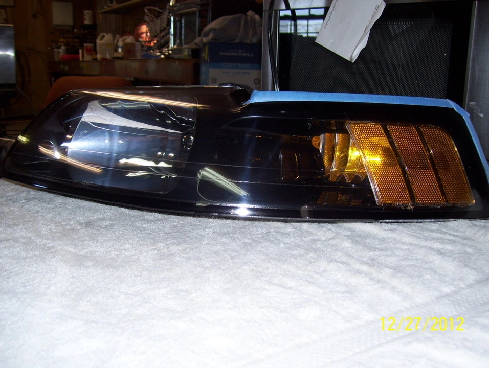

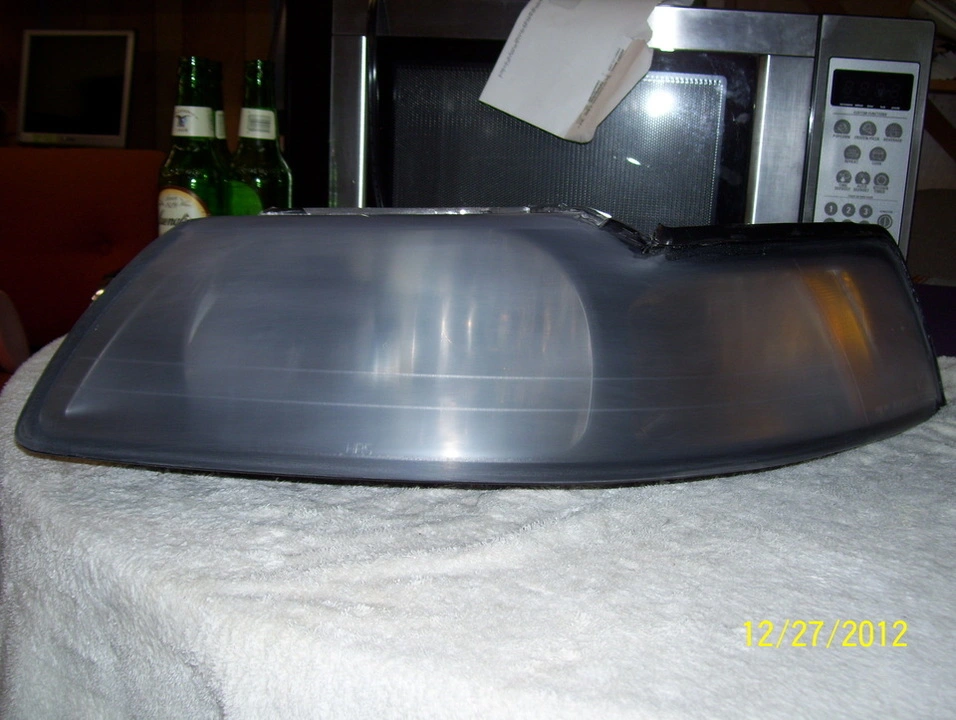

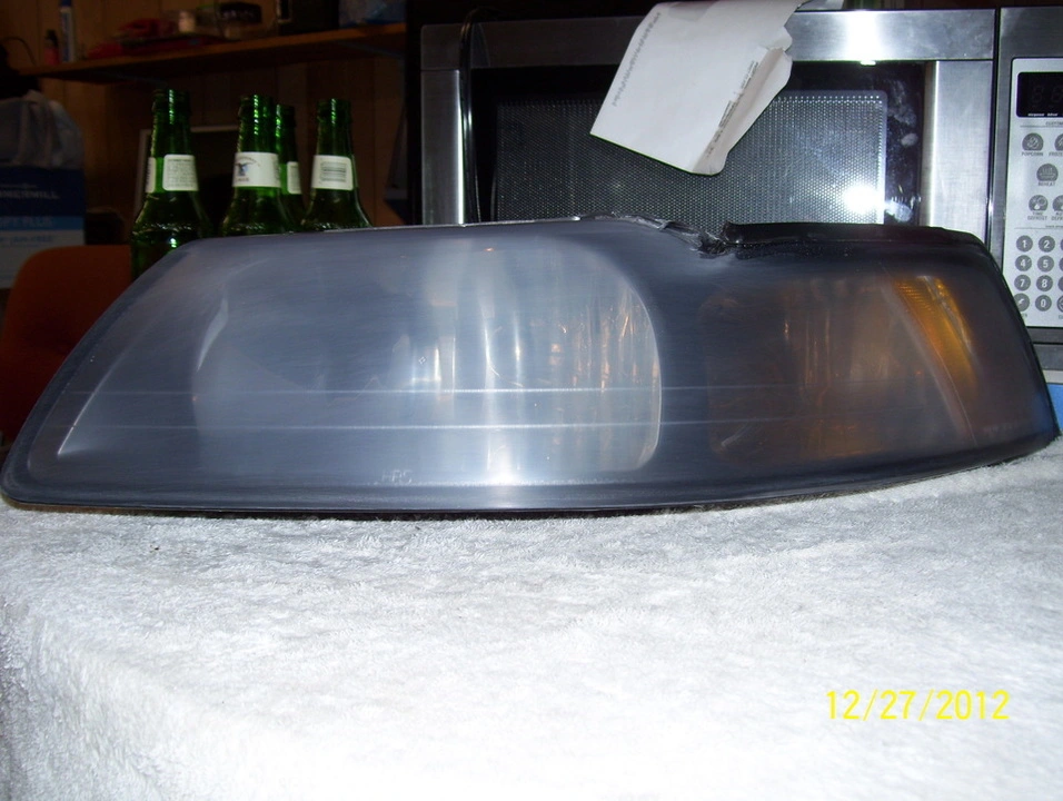

None of those OTC kits are going to fix your problem. From what I understand, there is a layer of UV protection on the outside of the lenses; that layer cracking and peeling is what you see that looks so bad. The only way to fix it is to completely sand it down and compound/polish it out. It isn't very hard to do (assuming you have a DA buffer of some sort), but it is a lot of work. I spent around 10 hours on these headlights (my granddad's), and I'd consider that a 'quick' job.
Here's what it looked like at the beginning (probably what your's looks like). Notice the scratches on the side and all the tiny specks all over the lense.
Sanded with 250 grit:
Sanded with 600 grit:
I sanded with 1000 grit, but didn't take a picture.
Sanded with 1500 grit:
2000 grit:

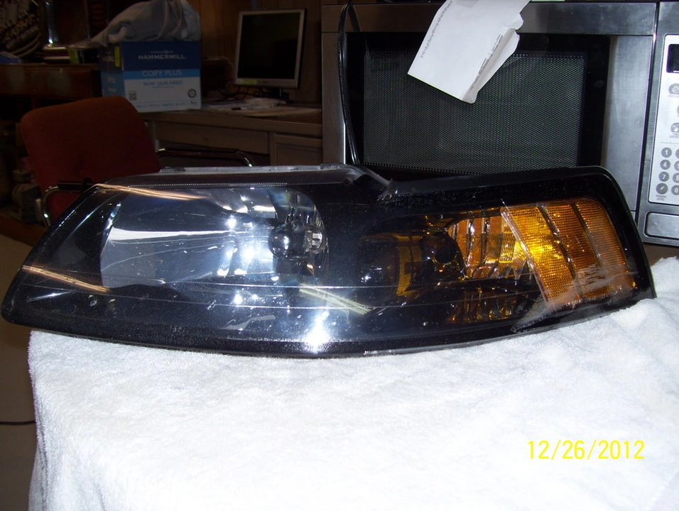

Compounded/polished with Meguiars 105 and 205, with a Porter Cable DA polisher:
Notice that it's completely clear with no flaking. If you look super closely, you can see a few sanding marks that I didn't get out, but that's very minor. 99.99% of people wouldn't notice it.
If you do this, remember that you no longer have that UV protection layer on the lens; be sure to keep wax on the light to protect it and keep it from fading (not really a big deal).

Wow thanks fellas I appreciate it a lot. Sneaky mine look worse than your grandads but I think I can save them. I'm up at college right now and don't have access to any tools to use so I have to do it by hand... Do you think it could be done if I do it by hand or should I just wait or pay someone to do it? I noticed there's a shop in town advertising that they can restore old headlights but I dont know how much they charge and if its a good price.
Btw sorry about the pictures not being up yet, it rained like crazy today and I need a sunny dry day to take a good picture.

That's exactly how my granddad's looked, except your's is over a larger area. However, that doesn't really matter. Once one part of it starts to peel like that, the only way to fix them is to sand all of it off. If you only sand a certain area, you'll still be able to tell the difference.
I didn't explicitly say this, but all the sanding was wet sanding.
Can't argue with Sneaky's results. The lights look good as new. 10 hours though...yikes
Yea, and that was definitely on the low end. Someone who knows more about it may could do it more quickly, but figure this: 2 passes over the whole light with 250, 2 passes with 600, 2 passes with the 1000, 3 passes with 1500, 3 passes with 2000, 3 passes with M105, 2 passes with the M205, and a coat of wax. And then double that (for the other light). Yea....the time adds up quickly. And, at some point, you WILL wish that your arm would fall off. It sounds excessive, but if you want it to look perfect, you have to spend enough time on each grit to be sure to get all of the previous grit's sanding marks out.

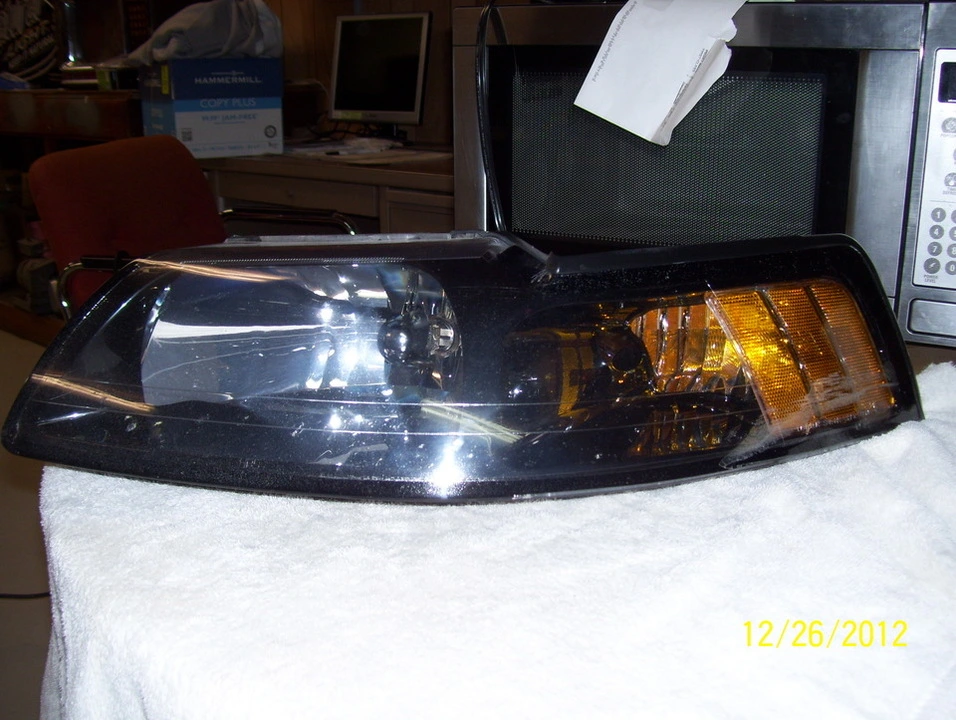

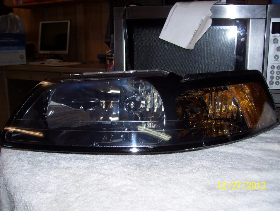

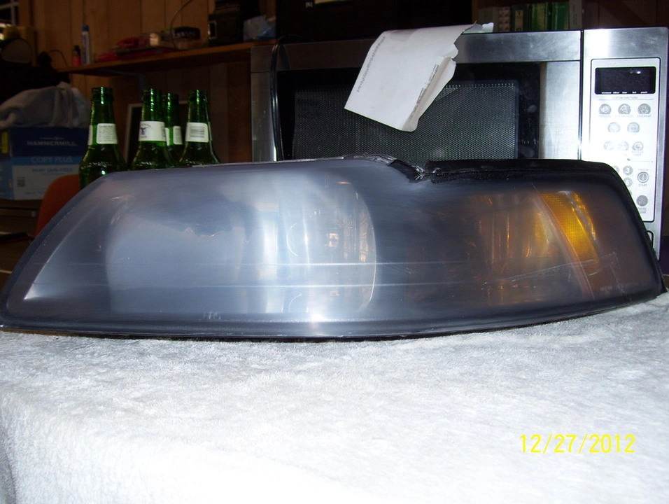

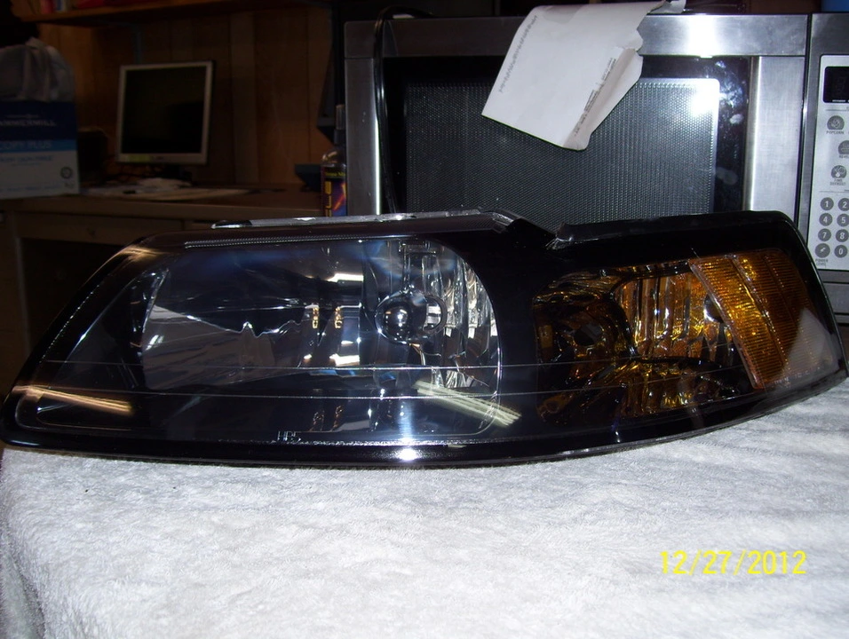

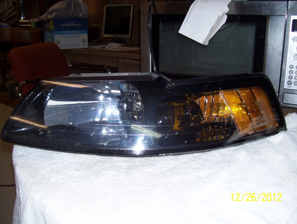

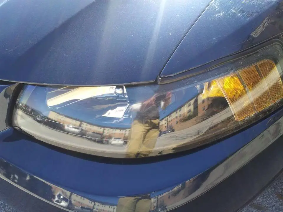

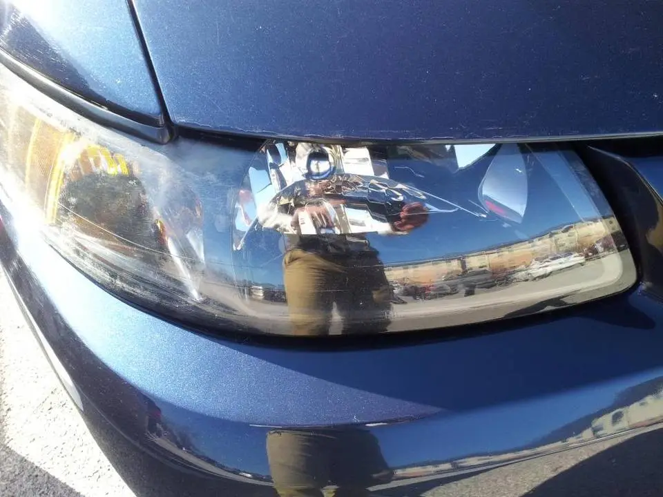

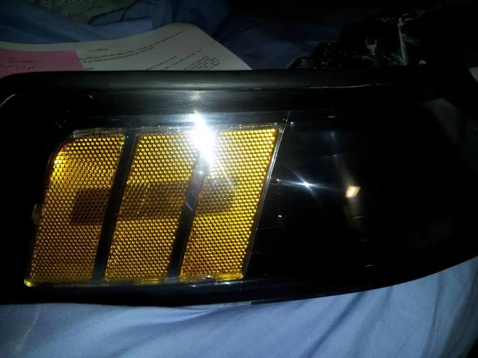

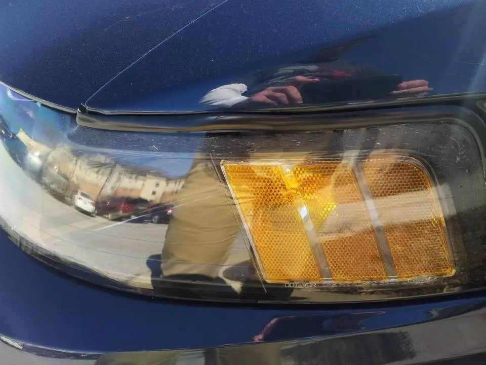

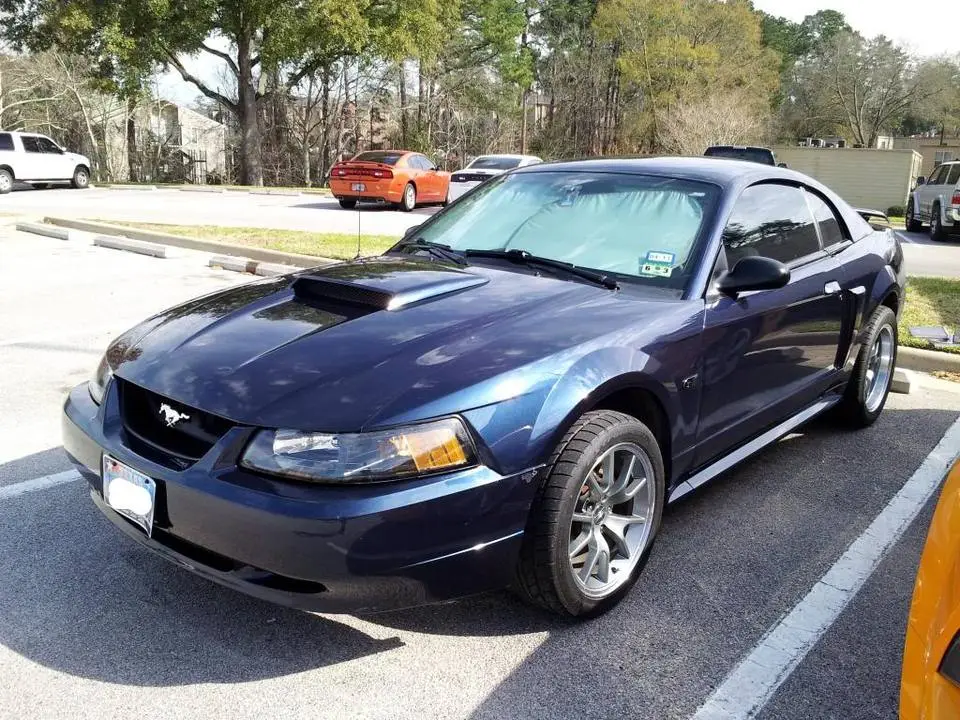

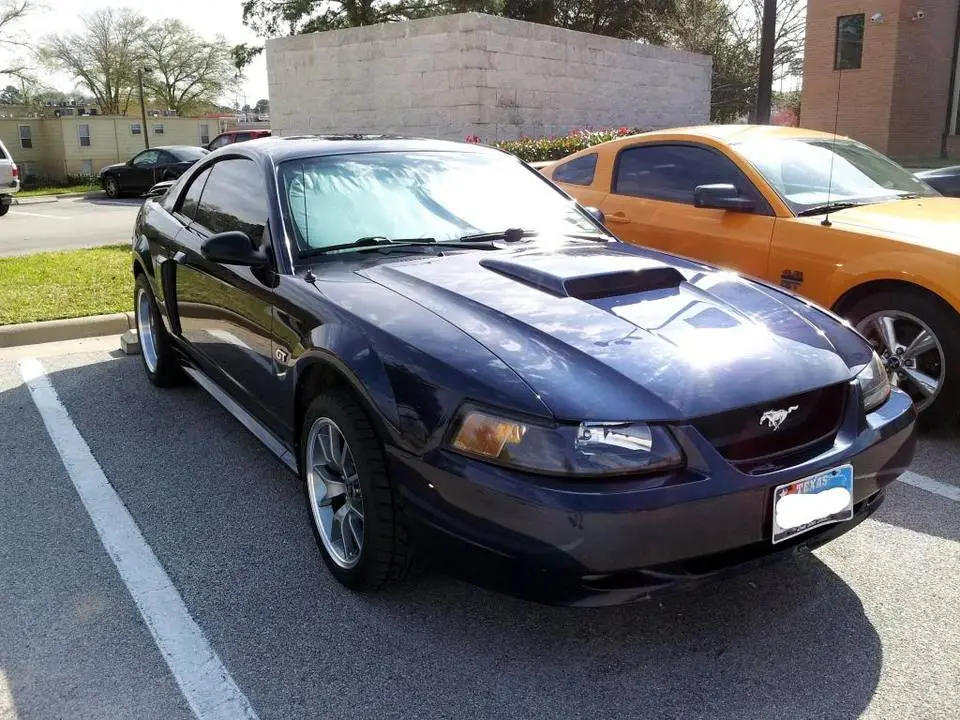

Got the passenger side headlight done, I have to say the 3M kit did a great job for what it is. I only spent about 2 hours on this headlight too and this is the worst one. Im going to start on the driver side sometime tomorrow when I can. Let me know what you think.
Thanks SRT Handz, Ill watch it sometime soon. I am satisfied with the 3M headlight kit though so I recommend using it.
Well I went ahead and detailed my car today, I figured I would post it here instead of posting a new thread... All I did was use Meguairs gold class soap, then used the Meguairs liquid cleaner wax. Kinda a pain to do in a self service car wash place because I dont have a proper driveway to wash my car... Sucks I have to carry quarters now to use a high pressure hose lol.
excellent turn around on those headlights my friend! always wondered how the 3m kit actually worked - looks pretty good to me. did you seal them with anything after polishing?
