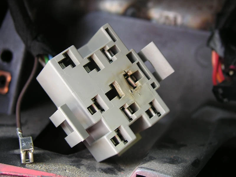

Exactly what I was thinking. Make sure the harness isn't melted like mine was:
If it is, replace that harness section.

damn that conecter took a little heat glad it ddn't get any worse

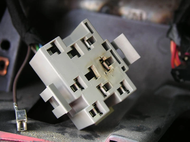

I had the same problem...my harness fried exactly like this one.

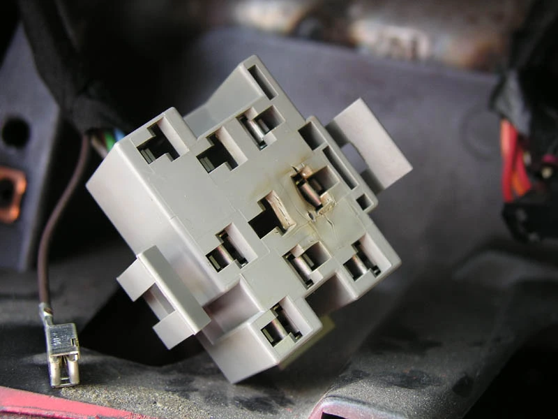

Mine looks like that... I'm gunna put one in from my other mustang and it should help.. I also put in a new headlight switch and it worked!
now how long will this one last? haha..
Thanks guys.
