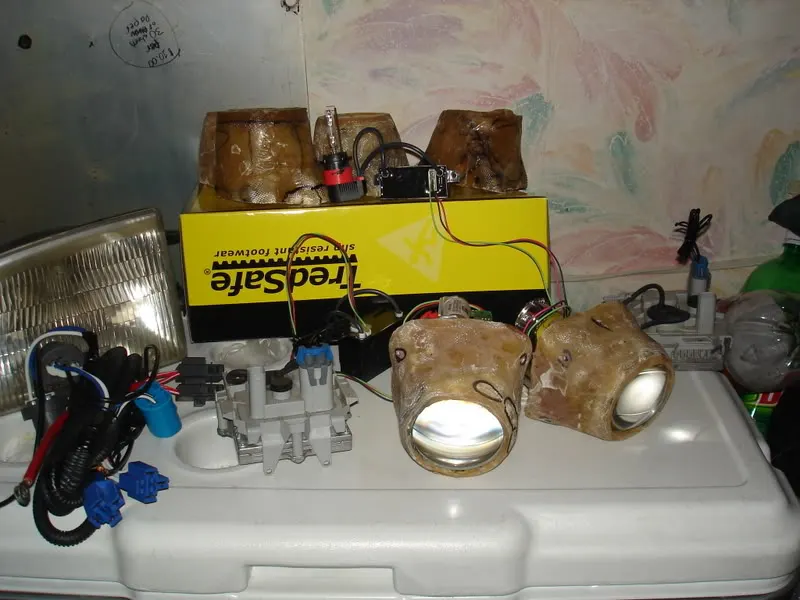

I just realized I have two projector headlights in my attic and my stock lights to practice on. :D

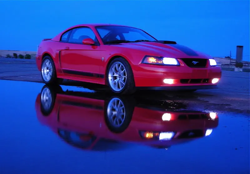

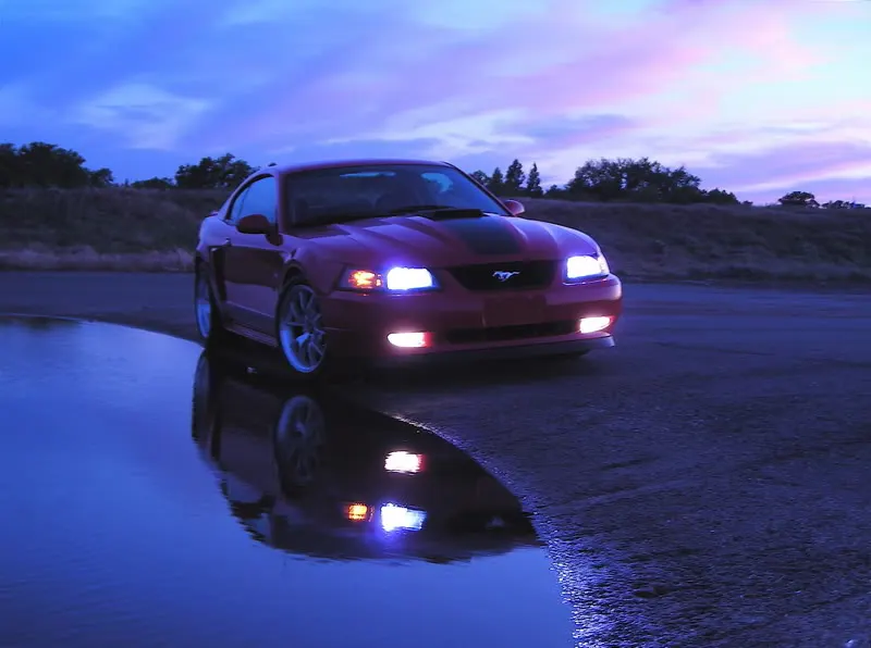

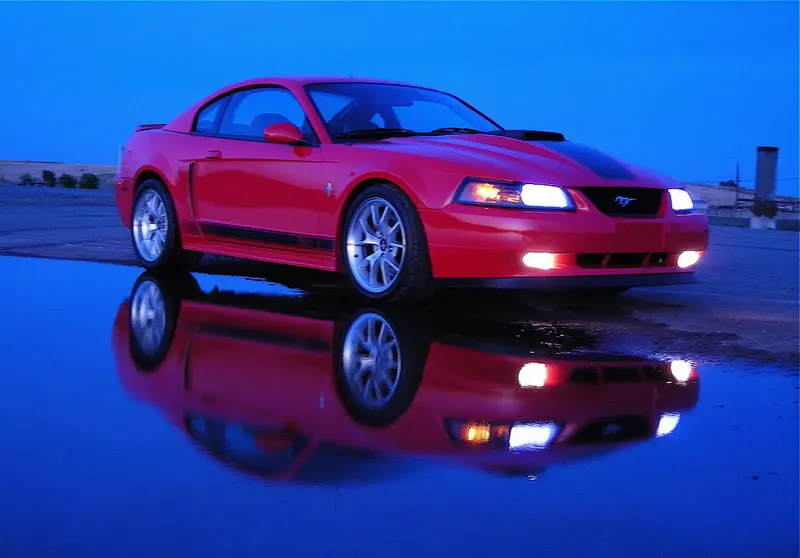

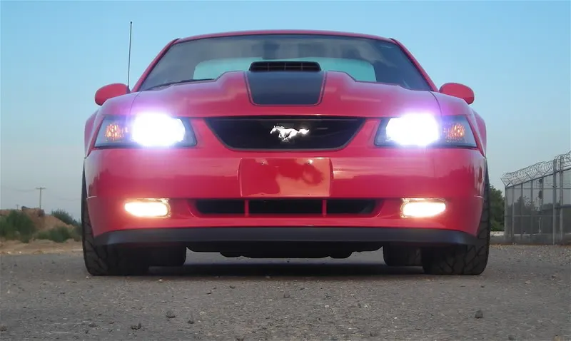

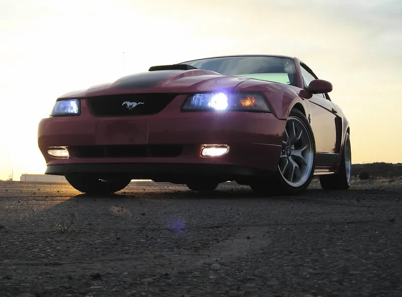

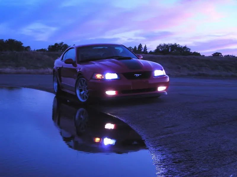

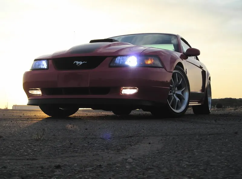

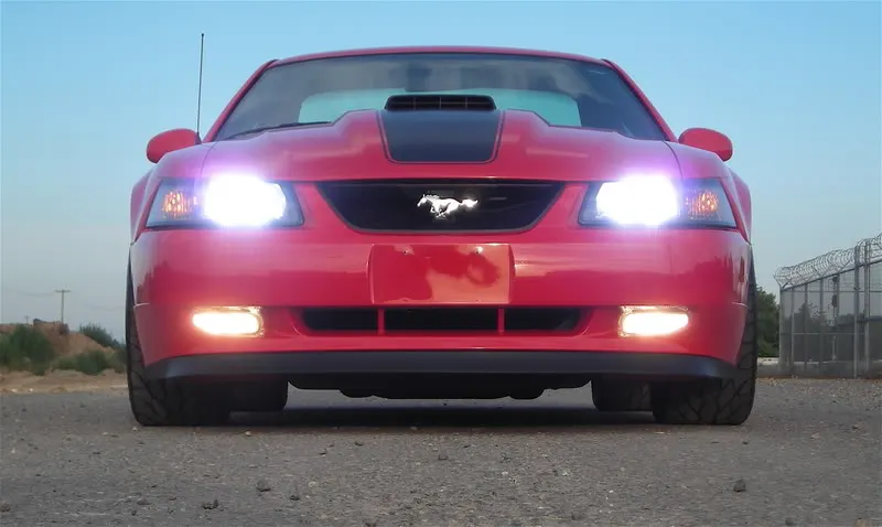

I have 8 or 6k HID's in my 03 Mach, & although they look alot better than stock because theyre whiter & brighter, but in the stock housing they glare so much that I had to aim them down. It seems like they are bright as hell right in front of me, but u cant see very far down the road, & the cutoff line is pretty horrible too. they do make the car look alot more modern & high tech though. Ive probably only been flashed like 3 times & ive been running them for about 7 months now....
Heres a few pics...

...It seems like they are bright as hell right in front of me, but u cant see very far down the road, & the cutoff line is pretty horrible too.
That is exactly what is holding me back from buying the Bi-Xenon kit from the link that was posted earlier. Thanks for posting and giving some honest feedback. BTW, your Mach is very nice!

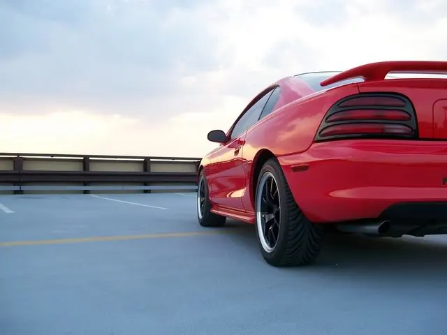

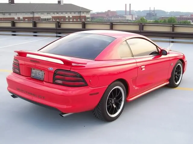

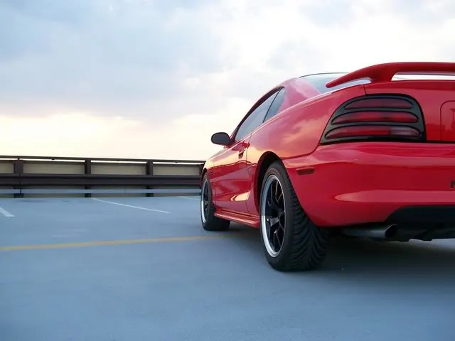

Thanks....Im diggin your SN95 too.... The black FR's look nice.... BTW, this is off the subject, but do u have a pic of the rear of your car, because I want to see how the black bezels look on your tailights. I am considering doing this to my 95GT....

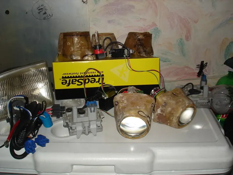

And I have a solution For Poor Lighting ITs PROJECT BLIND EM!
:D :nice: :cool: :banana:
heres a preview.
I will start a New Thread later with more pics.:flag: :nice:
