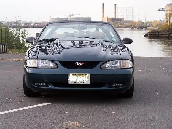

I tried the projector lights and they sucked as bad as stock! I now have clear likr the Cobra and that made a huge improvement...these plus some Sylvania Silverstar bulbs really make it brighter. I also put in some clear fogs and that helped too.
Plus it really adds in the look dept. find the stuff at www.50resto.com
