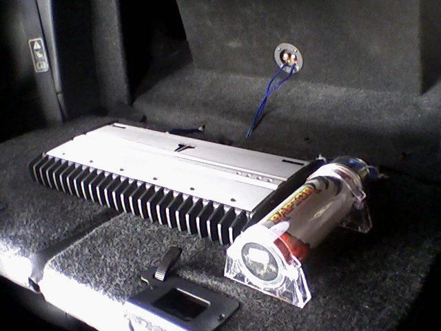

I have a 800X2 and a 300X4 and my 1 farad cap was just fine:

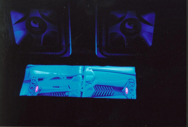

If you are going for a blue look, this is what I did:

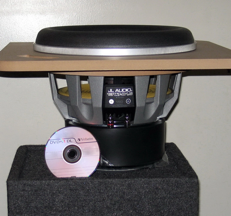

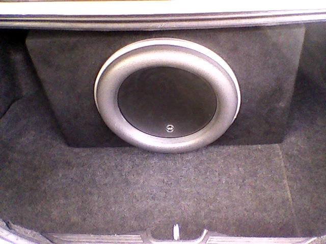

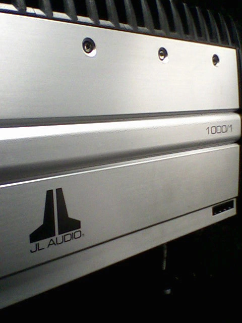

I have a single JL audio 13W7 subwoofer and a JL audio 1000W mono block amp installed in my 00 GT and my lights will dim if I turn it up pretty loud, Ive been able to improve this problem by replacing the stock battery with an Optima yellow top and I also did the "Big 3 wire" upgrade (Link) The majority of people suggest I add a 2nd battery to fix it completely but I'm trying to avoid that route due to the added weight.
I also have some pretty bad rattle issues.. The sub is so powerful its actually causing new rattles to pop up, most recently my dome light assembly in the car start rattling and the rear wing recently started making so much noise I thought it was going to fall off, upon inspection I was able to literally turn the nuts holding the wing by hand! but I fixed it by installing lock-nuts.
The shop that installed everything says they can fix all my rattles with dynamat etc. I may have to let them take care of it but I'm guessing it wont be to cheap..
