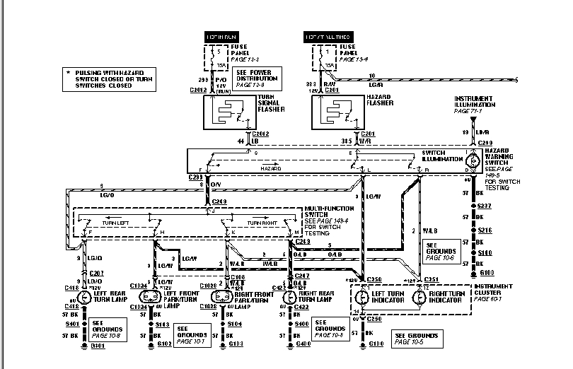

I can turn the headlight switch on and the dash gauges will light up but headlights won't turn on. If I turn the blinkers on, the arrow on the dash will stay on solid and same for the taillight blinkers just stays on solid. Hoping for a simple fix. Any idea's?
Check the wiring connectors for the multifunction switch. There may be a loose ire or one that overheated and damaged things.

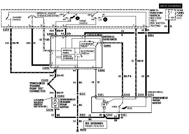

Since I don't make house calls to New York it is ether use the diagrams to find the problem or pay $$$ for someone else to fix it.
I posted the electrical diagrams for your model & year car. It is time to get out your multimeter and start tracing the wiring until you find the fault.
Yes. I was having an issue of my head lights not turning on, blinkers not blinking, low coolant sensor not getting power. It was the C108 connector disconnected. Probably came disconnected while I was removing my master cylinder and brake booster during my 5 lug swap since the main wire harness runs in that area. The C108 connector runs underneath the battery tray and connects right next to the battery tray.
Do you happen to have page 13-11and 149-1 From that diagram book? Reference is in the top right of top photo, the headlight switch testing. Thanks
