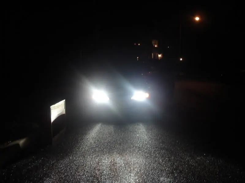

Hey Adam, while we're on this, and you have the HIDs, could you take a night time picture of the lights up against a wall or something, it would be nice to see just how bad the glare/cutoff is with HIDs and our stock style headlamps.
Adam95GT
Aug 14, 2006
2,564
Burlington, NJ
Mar 28, 2008
#14
  • Mar 28, 2008
  • #14
hid pictures are above. the new kit is still in box and my car in in pieces or else id take wall pics for you. as you can tell they are bright and i can actually see... but blotchy
