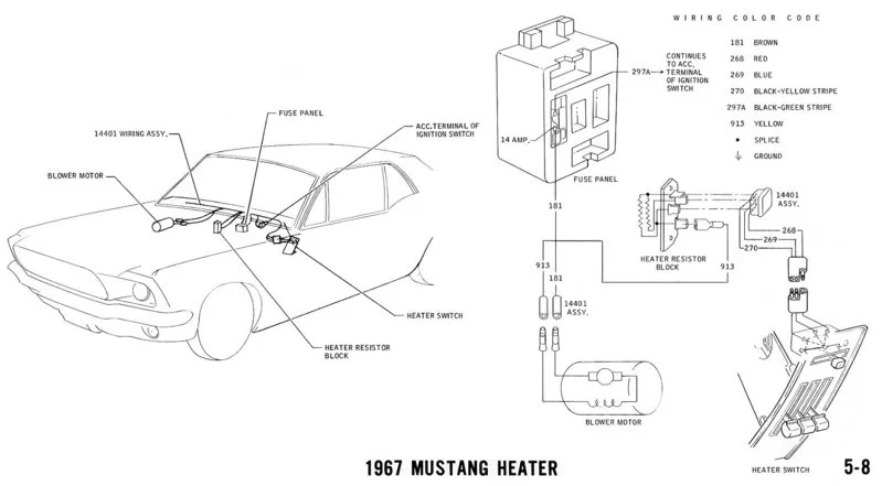

i was looking under my hood and i noticed some how my heater isnt connected what do i connect the 2 wires in the back of the heater motor to? a pic would be nice and it would make it easier on me
One of the wires goes to the fuse panel and the other one to the resistors in the heater box, as shown in the diagram. I really don't know which one goes to which connector, when I connect mine the original wires were gone so it was a trial and error thing.

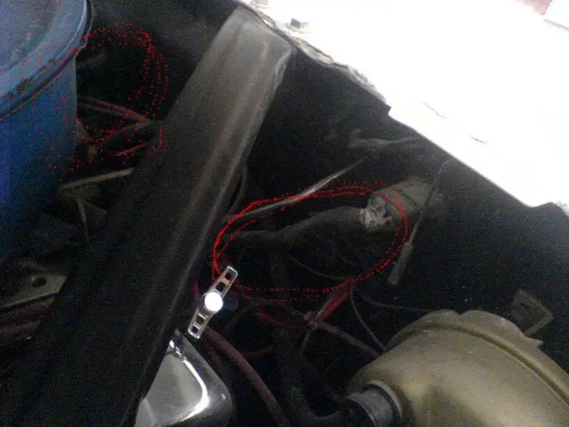

Here is a pic showing where mine connects:
The two wires connect behind the air filter and that goes into a bundle of wires that connect to the firewall where the 2nd darker circle is
Edit: This is for a 66 just noticed that Dothang67 posted right before i did ;)
