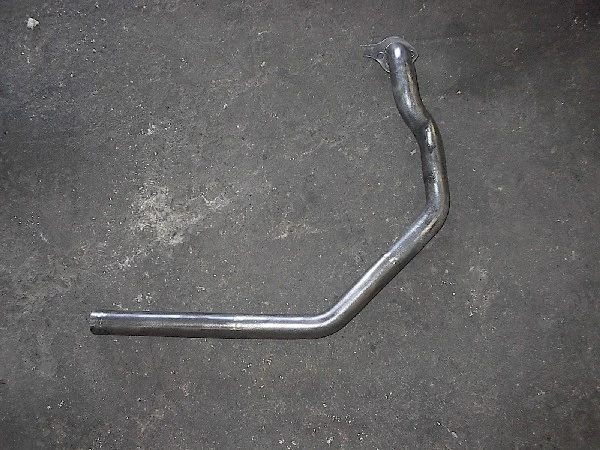

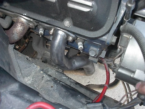

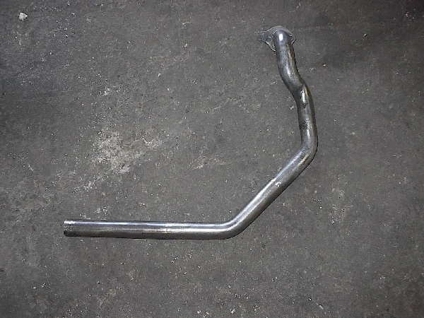

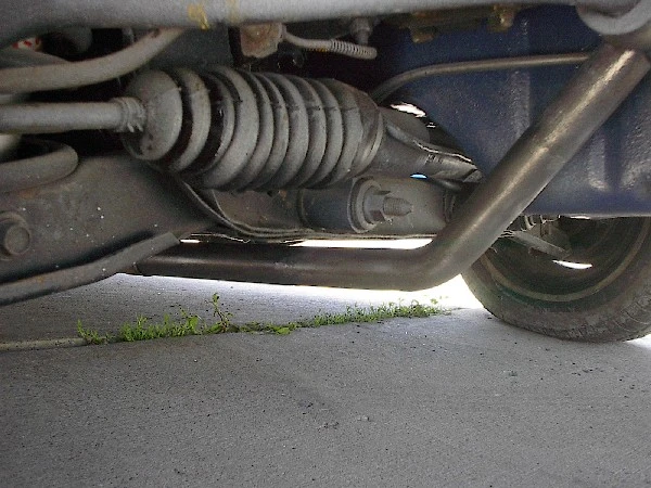

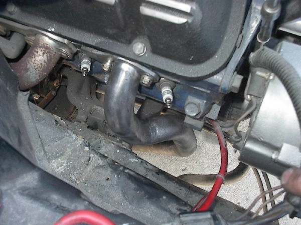

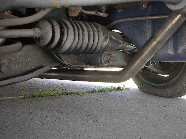

I used the dreaded Heddman 30s headers on my car. But with the 351's extra height and width I had to do a lot of modifications to them to make them fit the 351. I had changed the top of the #1 tube to clear the frame rail but left the bottom alone. I figured new new V8 A/C front springs I'd be ok. Not even close! So after redoing the bottom 90 twice I decided to make it the way it should have been done in the first place (barring going over the x member like the rest of the pipes). And with new heavier front springs I should be OK.
The main problem is that the 90 bend at the bottom is low and in front of the front tire angle of attack. Meaning anything much higher than a pebble hits the pipe before the tire gets to lift the car over it.
I cut the bottom off and put on 2 45 bends from some old header pipes and with the help of Mike and another garage-mate. This is what we came up with.
Here are pictures of the finished product.
The tire will now roll over anything before the pipe has a chance to hit it. Now If I bottom out and smash this one. I am going to have a lot more than a little header pipe to replace.

I'm not sure what you mean. Do you have a 351? If not remember the 351 is about an inch taller so that would make up for what you are talking about.
Tim

It looks like the other header pipes are too close to the fender apron? Man I would not want to have to tighten those header bolts ..whoahisme! I had a hard enough time getting the darn bolts on my 302 headers. It looks like you done some good welding.. did you pressure test it to be sure you didn't have any leaks?

Yeah, its a 351W, stock height everything, and stock E7TE heads. But I have about 1.2" of room between the inner fender and the engine. Maybe its the picture/camera, but it looks like you have 2-3" there. :shrug:
I'm not sure why things would look different. :shrug: I'll get some more shots withthe battery out when I get home from this weekend. I'm out of town at the moment. I used the stock mounts and all. I did have to do a little massaging of the left inner fender. The header bolts don't seem any more of PITA than any other header bolts. At least I didn't think so. I did cut the #4 pipe loose and I put in in seperate as well.
