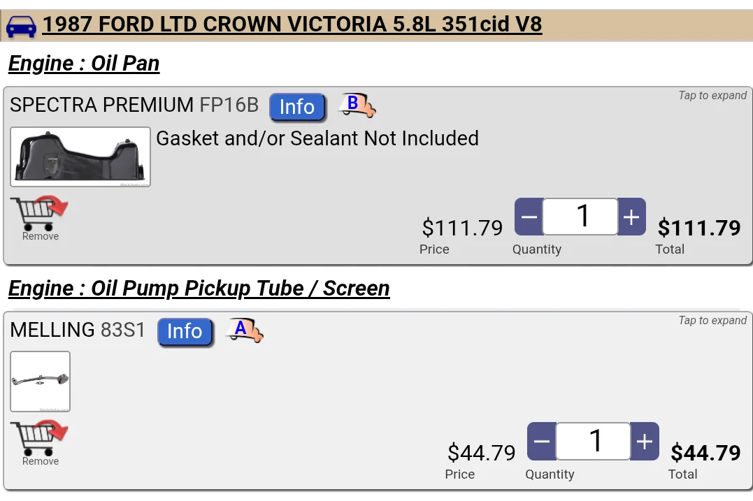

Does your 351w have an oil pan compatible with the fox? I just spent $300 on the conversion pan/pickup/dipstick.
I've done the 351 swap before, 20+ yrs ago. So i know all about the fitment hurdles
Drop mounts and k member spacers are coming to help.
You can get the pan cheap....same one that Ford puts in the swap package

Then, in that vein, I'd say the A/R won't matter to ya, either. It's going to spool quick enough and make good power for a street car, either way.
