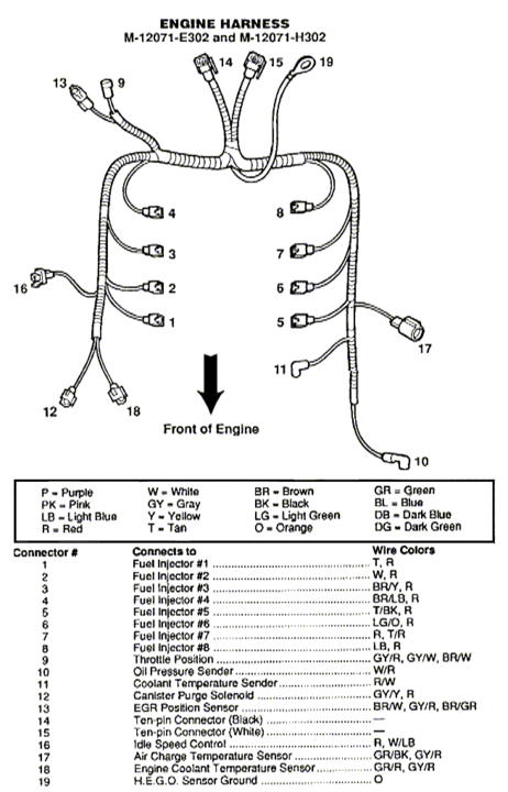

OonDeanisS Founding Member Jun 16, 2002 902 1 19 Danbury, CT Apr 16, 2008 #3 Apr 16, 2008 #3 oh no kidding, alright, well i read that someone had extended their HEGO ground wire to the engine block and it cleared up a hesitation issue at part throttle that i also have, so i wanted to give it a try. can anyone clarify this any more?
HISSIN50 "How long does it take to get help in here? 15 Year Member Nov 29, 1999 31,179 34 129 Apr 17, 2008 #4 Apr 17, 2008 #4 They might have meant the orange wire. It affixes to the back of the engine. Here's a harness pic. See #19. Thanks to S&2B's (site host) and Tom Moss (author).
