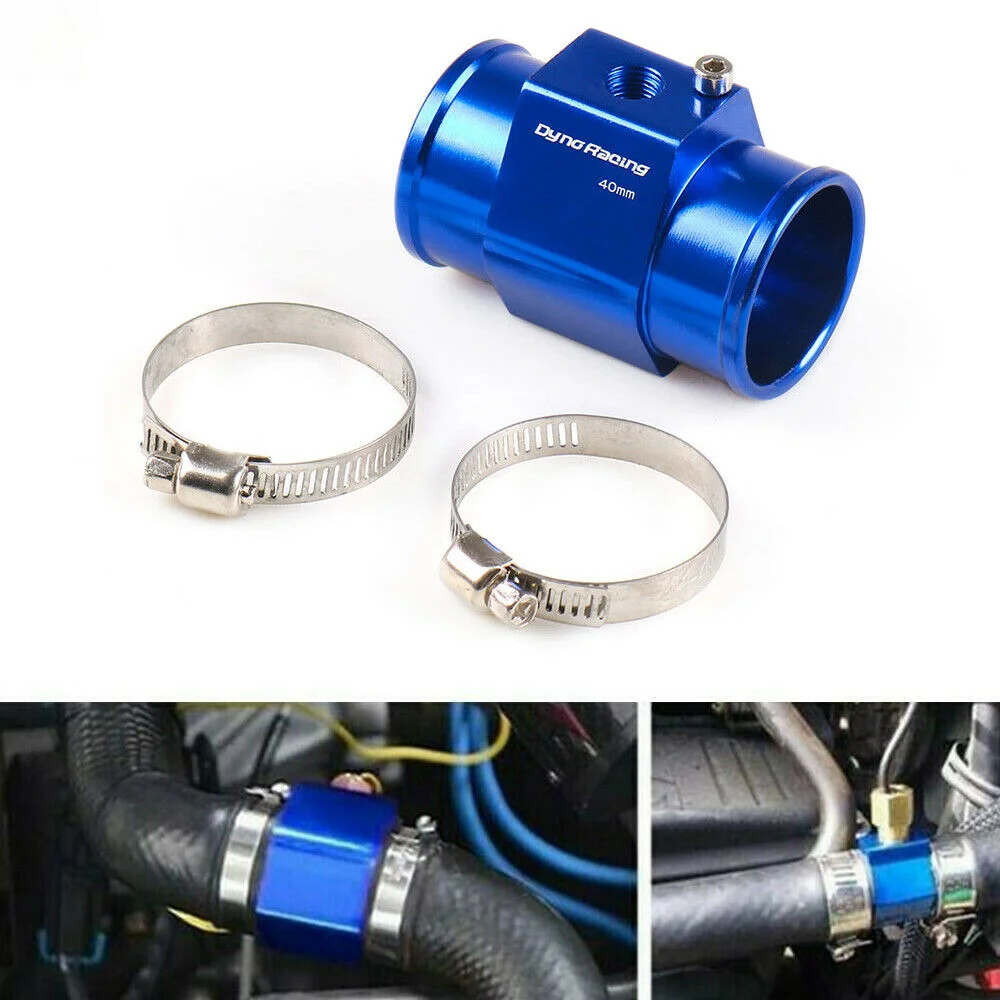

I picked up one of these on eBay and mounted in the lower rad hose. You just cut it, put this in and thread in the sensor you like.
10 years ago when I was building my car I made one out of a piece of pipe (drilled and added a bung and double clamped - this solution will work much better and easier). I have since accumulated a couple of these to use for future builds.
They come with a 1/8" NPT threaded hole (very common size for temp sensors) and a screw to attach a ground wire. For a stock foxbody lower hose you will want the 40mm size.
