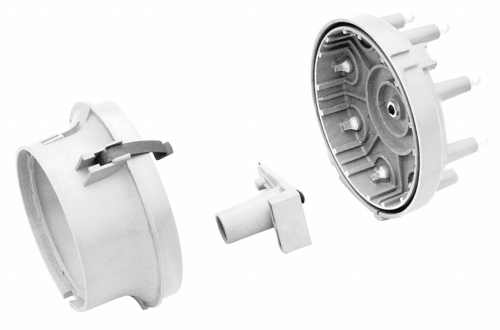

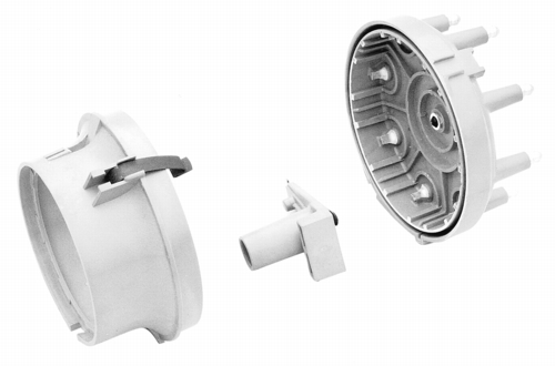

The adaptor is just a round piece of plastic that fits on the small distributor base and expands out to allow the fitting of the larger cap. It has indents on it for the cap to clip to. I used a MSD unit one time; very high quality. Do a search for MSD Cap-Adapt on their site. Ford Racing has started making a conversion kit with the cap and rotor for about $33.00 or $90.00 with 9mm wires included. I can't tell from the pic if it is a one or 2 piece design. You definitely want the two piece design so you can just buy a cap and rotor when it needs to be replaced. The other option is to get the adaptor from a junkyard for a couiple of dollars and then go to Autozone or Advance and get the cap and rotor. You could ask for many years to get the cap and rotor such as an 85 Mustang with a 5.0. You do need the larger rotor to due to the larger spacing of the treminals.
Great price but can you tell if the cap has the modern male posts or not? I prefer them to the old socket style; they seal alot better. I tried to click on the pic to enlarge but nothing happened. :shrug:
thats the enlarged pic. stupid black and white pics lol

Oh, I found a pic on Summit Racing.
they want 29 dollars

go buy the cap and rotor and adapter for an 84 mustang gt 4bbl. thats what i did, complete bolt on. advance auto parts, spent about 15 dollars for everything. i may upgrade to the motorcraft part or someone elses in the future just because the fit would probably be better. the parts store cap has the slightest amount of play when strapped down to the adapter, im assuming motorcraft pieces will cure this, but i just wanted to make sure it would work!
i found the Cap A Dapt that mustang dave was talking about origianlly. and it was 1 dollar cheaper than the ford part.
http://store.summitracing.com/partdetail.asp?part=8887
there's no pic there, but there is on MSD's site. it looks like the ford part, but its msd...brass terminals instead of aluminum... and 1 dollar cheaper like i said.
I think i'll buy that one. what you think?

do u have a msd distributor???? if not, it WILL NOT WORK! it says right there on the summite website, for msd distributors, not stock ones.
ok, that sounds better. i was gonna say the other one was for msd dizzys, that one looks like it should work, according to the msd website. although according to the summit website it will not work?????? see the application chart, it says stock distributor: no .now if only it came with a blue top instead of a red one. red would just throw off my whole engine compartment.
yes, please do. i am very curious since theres some confusion between the summit and msd site, although i tend to believe the msd site for obvious reasons. if it does work out, thats a great conversion for old distributors. i was very pleased with just adapting the late model cap
welp, I got the cap from fedex today. :) and new super conductor wires and spark plugs.
the wires were custom w/o ends put on, so me and my friend cut em to size and put the ends and boots on.
The cap works :) there is a slight problem with the air cleaner hitting the #1 cylinder spark wire on the cap.....by about 1/4 or 1/2 inch..so I think i'll need to get a 1" small diameter air cleaner assembly and it should be fine.
I had to put an adapter on the coil to make it a male terminal aswell. But that was no big deal. I had one that came with my Blaster 2 coil.
All's working, and it's working fine, so far. :)
