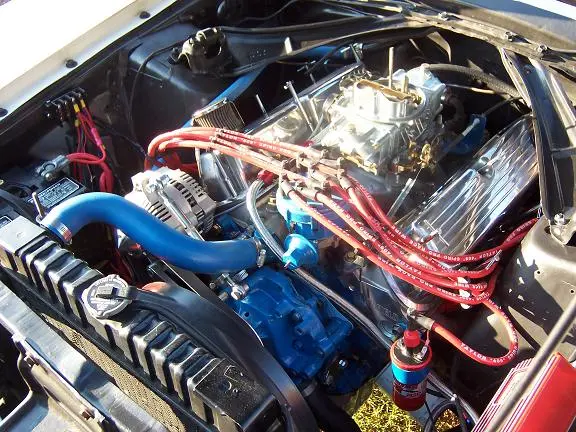

Here is a pic of a DS system in high perf use...
Pretty much identical to MSD units.
