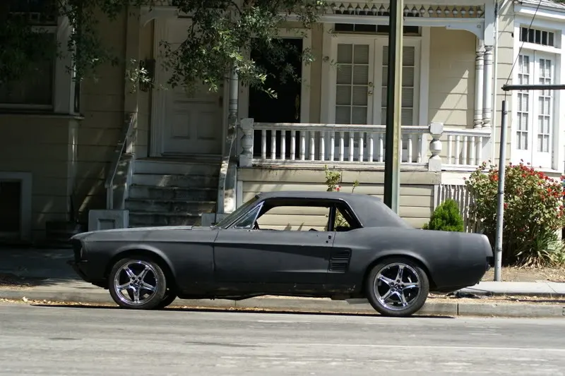

well here is a pic I took the other day
Max
The good first I guess
This car has a 93 Cobra Engine
It has been switched to Carb (holly 650)
It has the serpintine belt setup
New becool radiator w/ e fan
Ford Racing Clutch
T5 Trans
5 lug 9 Inch rear axle
Front disks
New front and rear seats
New front and rear glass
New headliner
New dash panels
Cobra R rims
The bad
Manual brakes
Manual steering
No Blinkers
No Back up lamps
Left Head light is dim
Right door glass ( 3 pieces) is not installed, I think there are parts missing
Door handles I think is missing parts
Over all the car feels really sloppy
O well hopefully I will get most of the problems fixed in the next week or so
