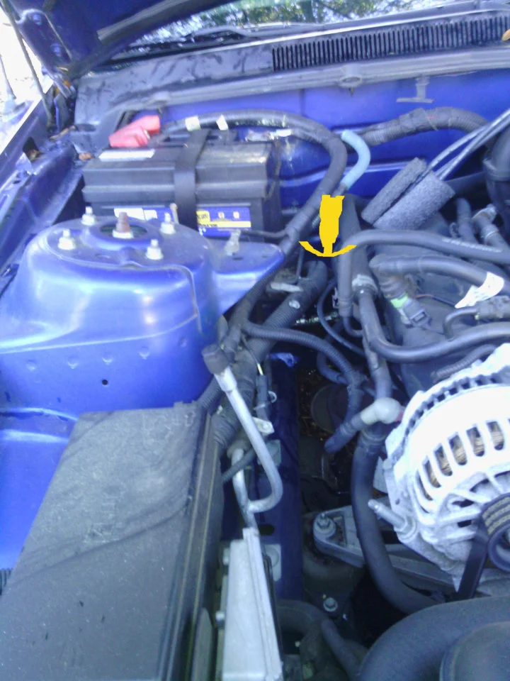

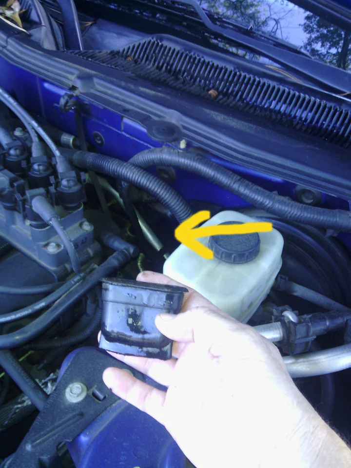

To stop the water from leaking in on the floor board there is two rubber drain pouches that build up crap in them especially if you park under trees. Open the hood and on the Fire Wall behind the motor. they are slightly difficult to see if you don't know what or where they are. You can stick your finger up in it but it is easier to just grab it and pull it down and out clean it then reinstall it. I will see if I can take a picture of it and post later. One is for the Cabin filter area. they catch the water off the windshield.
