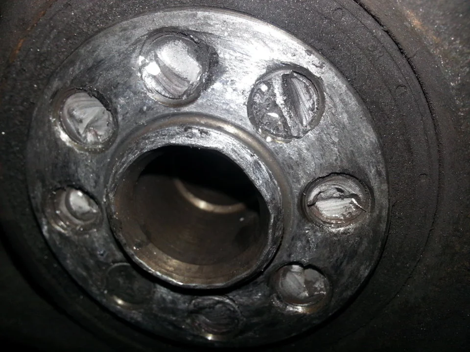

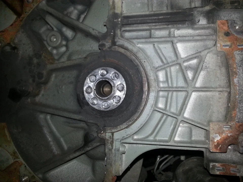

> aluminum flywheel snapped all the flywheel bolts and looks like it grinded the engine a little bit photo attached
I have no idea what todo from here I was gonna throw the oem flywheel back on but I was told I need to replace the crankshaft HALPPPPPP

I was told to drill out and use and ez out (ive done that before on a busted head) then sand clean and use the OEM flywheel again after resurfacing
in case I screw this up I was told to use a thread chaser, but I should just not screw it up more than I have

Shes Back on the road using the same clutchplate and pressureplate but went back to using the OEM flywheel (had no choice aluminum one is busted)
my girlfriend helped me out we used a punch and hammer to slowly turn the bolts out
when doing a clutch or flex plate swap one most remember the bolts are all torque to yield/stretch bolt's and can not be reused. those bolts will look like those when they do shear off
your lucky to have been able to save the crank
