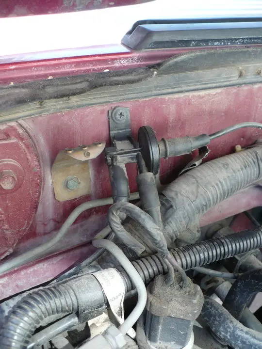

Did the check valve (along the passenger firewall) look ok? They crack.

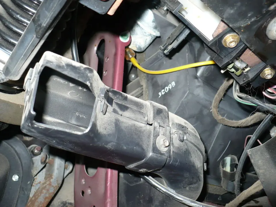

Check up in near/above the gas pedal if a yellow vacuum hose is disconnected from the canister. That is used to make the vents open when you select vents on your controls.
start here and then if not then go from there
Yep checked that one... here is a pic I snapped up there
and here is the rest of the pics I took of the vac lines and stuff yesterday...

umm... whats the check valve look like?:shrug:
You should have seen it when you traced the line along the firewall. It's just a black valve. If it broke, someone might have just put a connector in its place.
Edit: looks like it's there (could still be cracked though):
Top-left of the pic, just to the right of the passenger hood hinge. You can see a vac line going into what I think is your check valve.
http://s218.photobucket.com/albums/...lic/Mustang/?action=view&current=P1010903.jpg
