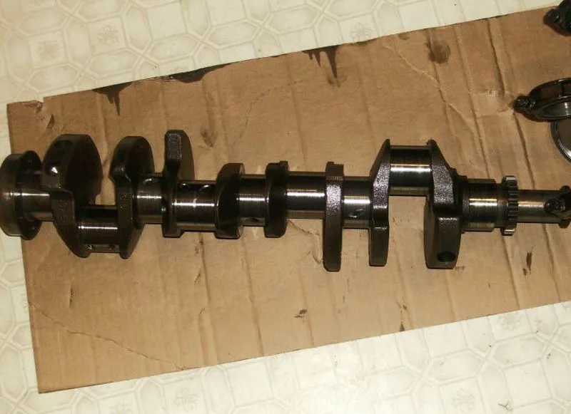

The 5.0 cranks are the only ones with holes completely thru the crank.

Hmmm… Flywheel bolt holes here…
