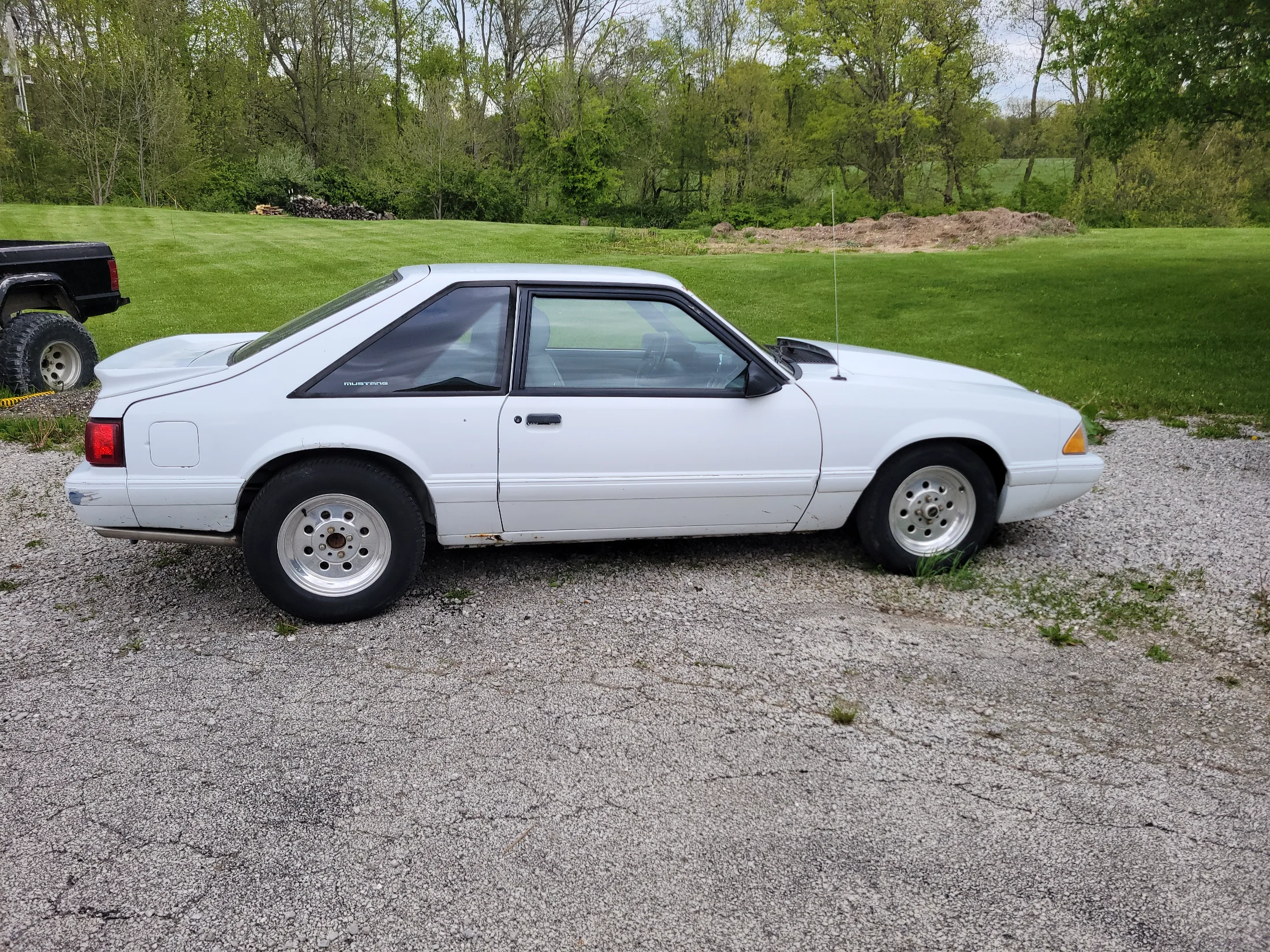

So i picked up my 89 fox earlier this year as something to just play around with. It came with a carb'd 347 with a c4 trans in it. Now from looking at the car, it looks like it was originally a 4cyl 5 speed car and the just cut the wire harness out of it and made it like an old school no frills car.
I am wanting to swap it over to a 5 speed as I'm not a fan of the auto that's in it. I'm not real familiar with mustangs as I've spent more time building jeeps so don't really know which year's are best for doing this type of swap. Are there years to avoid or ones that are easier to swap in it? I know I'm gonna have to get a flex plate, bell housing, pressure plate and clutch, and all that stuff. Just not real sure on main trans part and which one to get.

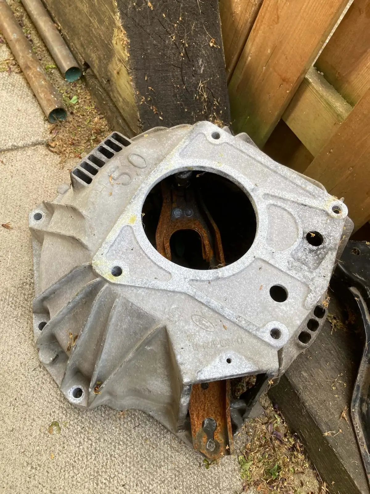

If you change the input shaft and bearing retainer you can use a 94-98 V6 T5 (rated at 265 ft lbs, same as the early V8 WC T5s) or the 94/95 V8 T5 (rated at 300 ft lbs) or the 99-04 V6 T5 (rated at 300 ft lbs - same gear set as the 90-95 V8 T5s). To not change the input shaft and bearing retainer you will need the hard to find 94/95 5.0 bellhousing - it is cast 5.0 into the housing. V6 bellhousings after 94 were cast 3.8.

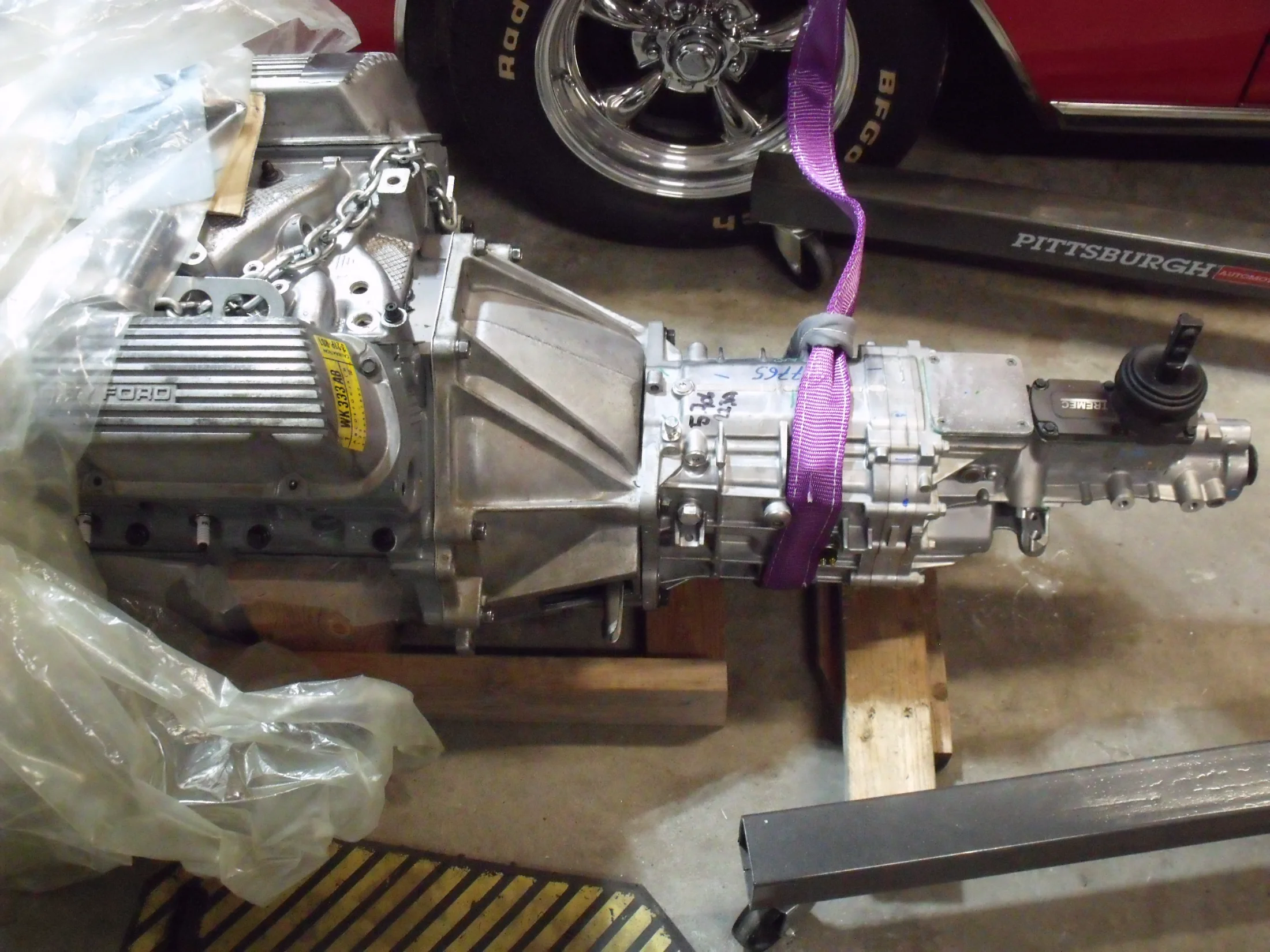

I have a complete T5 swap listed in the classifieds and would consider shipping. You would need:
- A clutch cable so I would suggest either a Steeda adjustable or an OEM one with a fire wall adjuster. When I say OEM I mean new old stock (NOS) as the aftermarket non-adjustable units are 99% trash.
- Flywheel & flywheel bolts (would suggest ARP)
- Clutch pressure plate bolts (again would suggest ARP)
- Pilot bearing
- Bell housing to engine block bolts (good Grade 8 bolts with hardened washers is what I use)
You may also need a VSS to get the Speedo to work. Not sure if the C4 uses one or not.
You would also most like need the NGS wiring harness but not sure with the car being carbed and you would need the reverse light switch harness.
Not sure if the drive shaft you have will work so you will need to do some research there.
