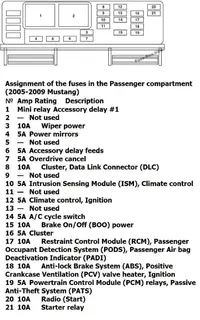

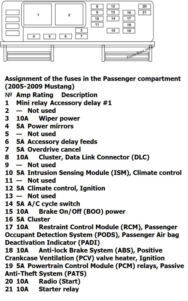

Check fuses 8, 10, 12, 14, and 16 in the smart junction box. Multiple electrical problems are often the result of corrosion of the terminals in the SJB due to water intrusion into the passenger side footwell. Remove the cowl covers and check the drains. If there's water, replace the cabin air filter as it's likely to be filthy.
