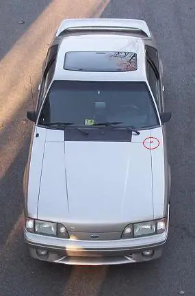

so my front left strut is dead. it doesnt rebound or whatever and its taking bumps really roughly. the right side is fine, but drivers side is like a rock. i have my new shocks and struts in but i wont be able to install them for a few more days here. i was thinking, can that bend my unibody? i have SFC's welded in. my strut mount bushings are dead, its knocking allot going from lock to lock ish and i feel like its messin with the alignment of all my pannels. i noticed when driving that i have a little dent now right here
on the quarter pannel directly across where the hood ends. some of the gaps seem t be off too. i just feel like its twisting my car somehow because when i hit a bump its throwing back all the weight to the other corners.

and i could see the panels moving around, if the strut isnt stopping the spring, something else will move.
and i seriously doubt the unibody is bent.
just replace the stuff and your problems should be solved.
