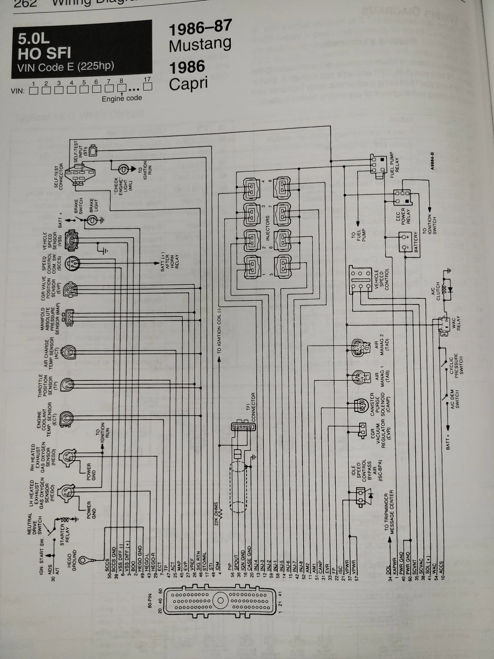

SMOKEDYA 20+ Year Stangneter Jul 13, 2003 3,637 8 79 Tucson AZ Jan 19, 2023 #1 Jan 19, 2023 #1 Looking for help trying to locate which pin is the KAM wire on the 60 pin connector. Also what voltage I should be getting from it and where the wire comes from. Thanks.
F FoxChasis 20+ Year Stangneter Dec 23, 2003 590 277 93 Jan 19, 2023 #2 Jan 19, 2023 #2 From 80-87 EEC book, by Probst Attachments 20230119_082933.webp 341.7 KB · Views: 145 Reactions: General karthief
Mustang5L5 That is…until I whipped out my Bissell Mod Dude Feb 18, 2001 43,347 18,081 224 Massachusetts Jan 19, 2023 #3 Jan 19, 2023 #3 Pin 1. Constant 12v fed from a fusible link. Last edited: Jan 19, 2023 Reactions: General karthief
