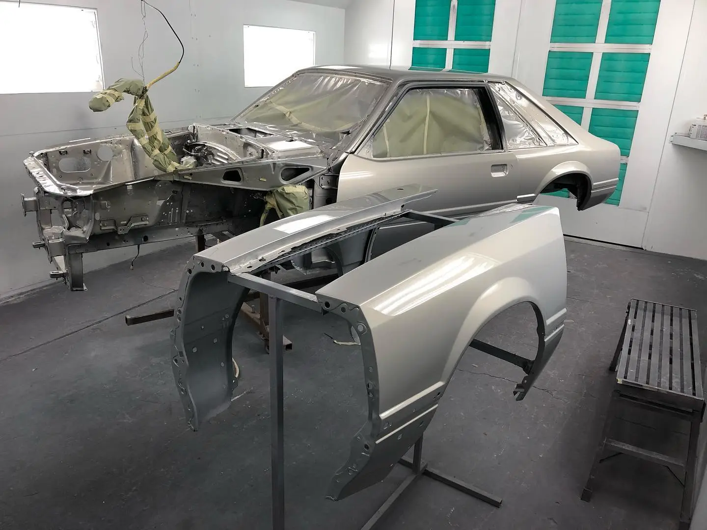

Below is a pic of it in the booth last September. It's back on the suspension now, but I don't have any photos yet. Color is Titanium Frost.
If you all are interested, I can post more pics or start a thread how how this project went.
