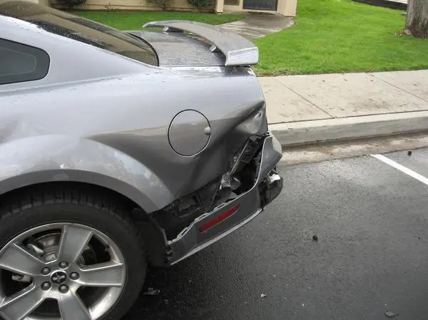

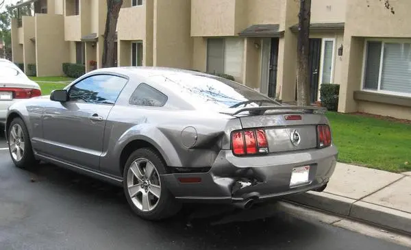

I just want to say that I feel your pain too! My 06 GT was the victim of a hit and run 2 weeks before the Super Bowl (to this day I'm convinced that it was a drunk Chargers fan who was pissed off his team lost!).
<p>Anyway, the car was in the shop for the past 3 weeks, and I just got it back yesterday evening. I have to say, the shop that did the work did an AWESOME job, I couldn't stop gushing about what great work they did. It was hit on the rear quarter, and the buckling and rippling went all the way up to the driver's side door. My trunk lid was even raised about a quarter inch from the impact. The shop pulled my stang too, and I'm guessing since you were rear-ended your damage is somewhat similar to mine. Visibly I can't even tell it was hit.
<p>I've attached some thumbs of the damage, like I said I got it back last night and it looks PERFECT!
