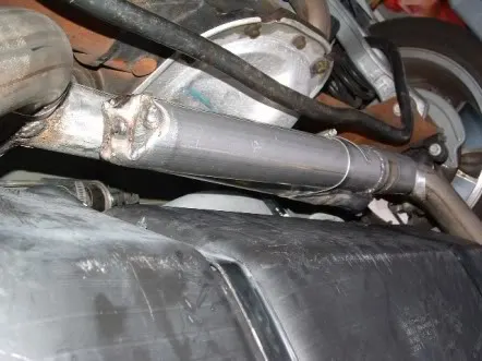

All this talk of undercoating and dynamat, I just can't imagine how much slower it's going to feel afterwards from all of the added weight. It's never going to be a living room on wheels. Now, for the interior drone, you can cut holes in the sides of the exhaust pipes right as they come over the axle, and weld a piece of pipe to each. Close up the ends of the pipes, and the drone should be gone without changing the sound out the back much, if any.

I'm sorry, but those "Dronemasters" look pretty shotty. :(
Ahaha, nooo. I call my Flowmasters 'dronemasters' because of the annoying drone that they make. They came with the car when I got it; I would never have bought them. Those welded in pipes in the picture were a test done by someone else, and they worked incredibly. I did the same thing, just much cleaner. Never had the time to take good pictures of it.
