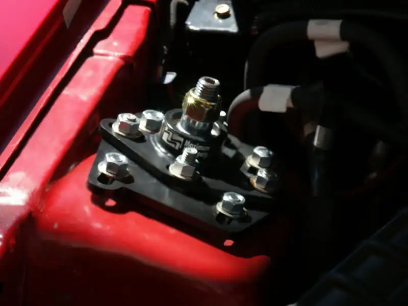

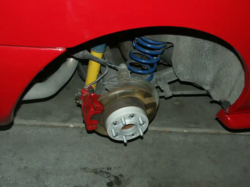

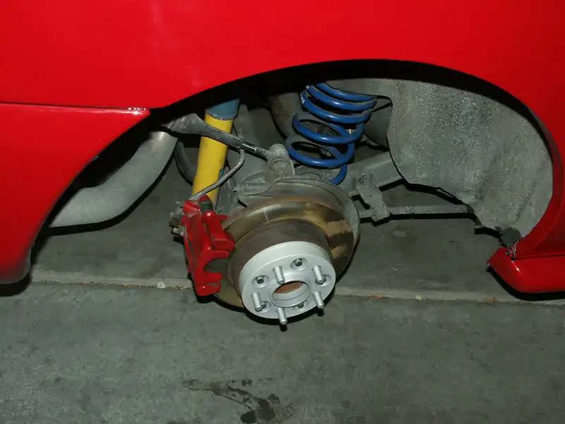

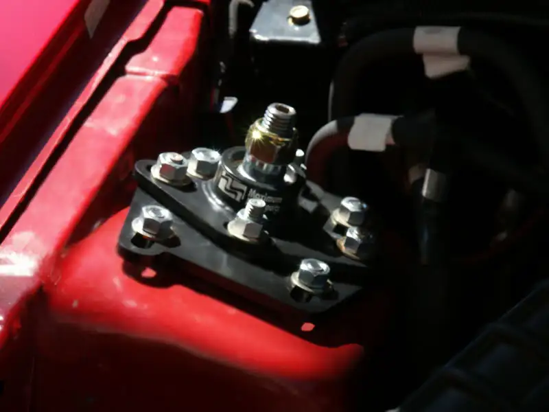

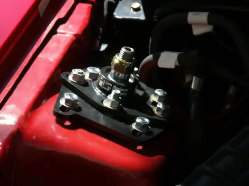

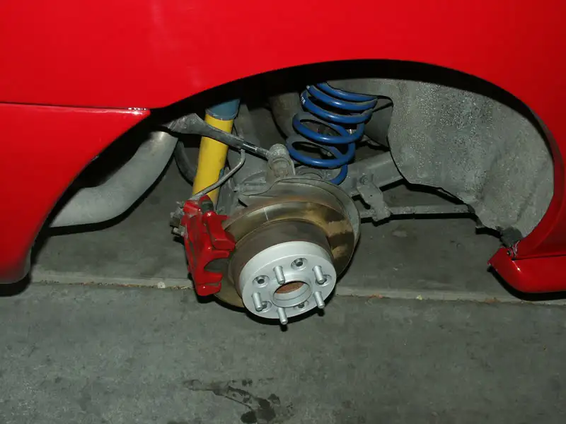

Get the springs and a nice set of C/C plates (Maximum Motorsports). Then maybe some spacers cause your rear wheels will look too inset.
Sweet! Thanks for the pics and advice. I have 18x10's, so I'd only need a 1/2" spacer to make it perfectly flush I think.
Also -- do the CC plates replace the strut mounts?
