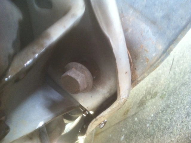

noticed slack in my front end. loooked under it today just by accident and this is what I saw. is this the A-arm? the nut is gone, where can I find one? can you get one to work like at lowes or any know part stores?

SROBERTLAW200
Don't drive that car!
I don't know if you can find the nut (is it a Grade 8?) at Lowe's but, for sure, your Ford parts counter guy can fix you up.
Do you have a Haynes manual? It has the torque specs for almost all fasteners on the car. The manual is only 20 bucks and it has a ton of good info in it.
HTH,
Chris
Glad you found it at a junkyard. You wont find that bad boy at a regular place, you would need to go to a fastener shop. If you need to torque spec for that nut let me know.
Just for reference, it can't be grade 8 because it is metric. They have a different system for fastener hardness.
