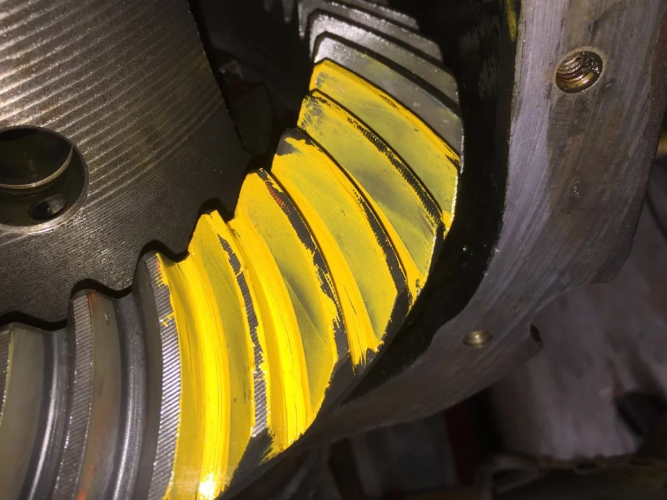

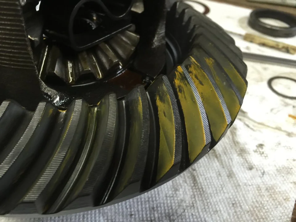

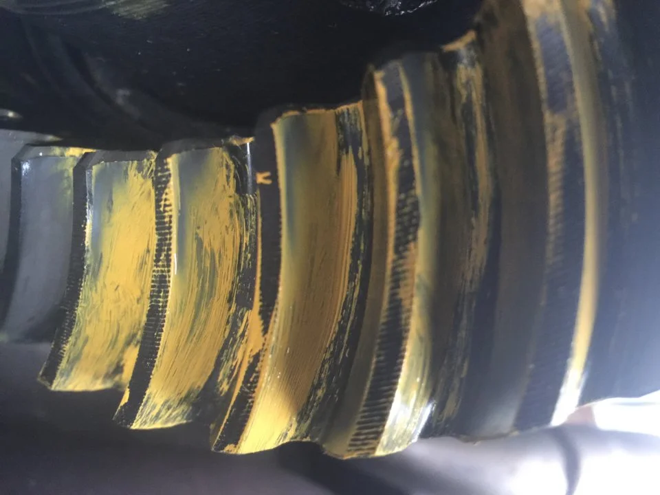

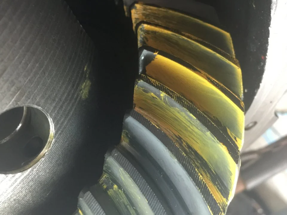

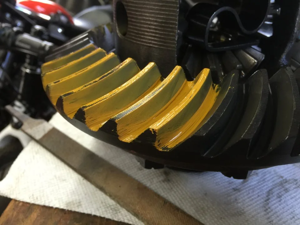

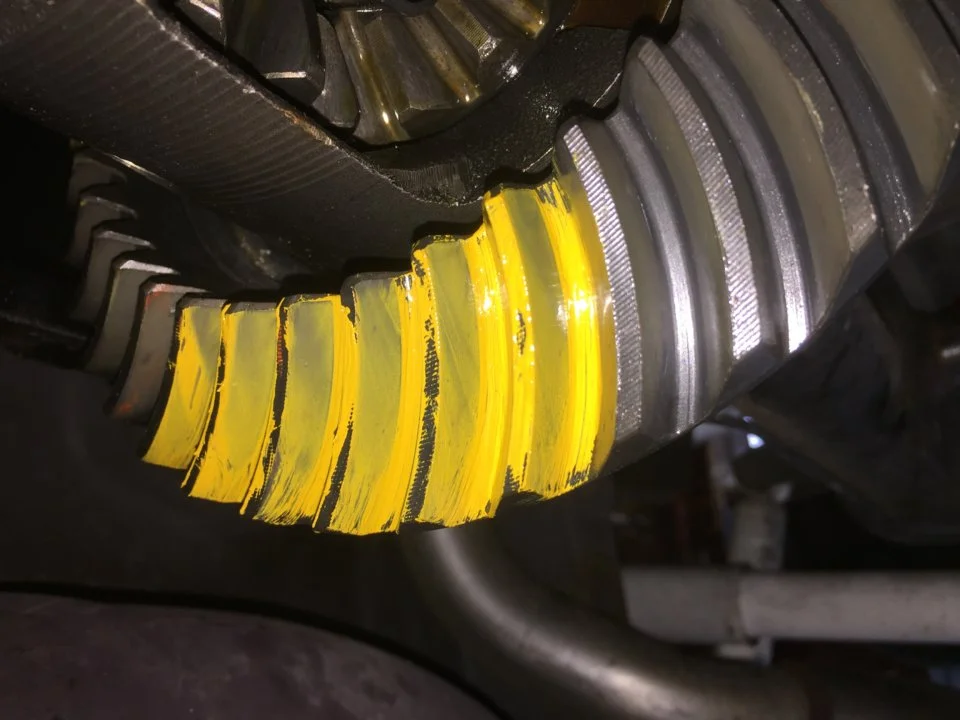

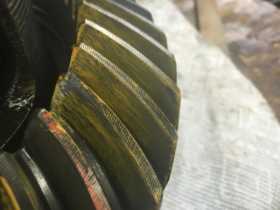

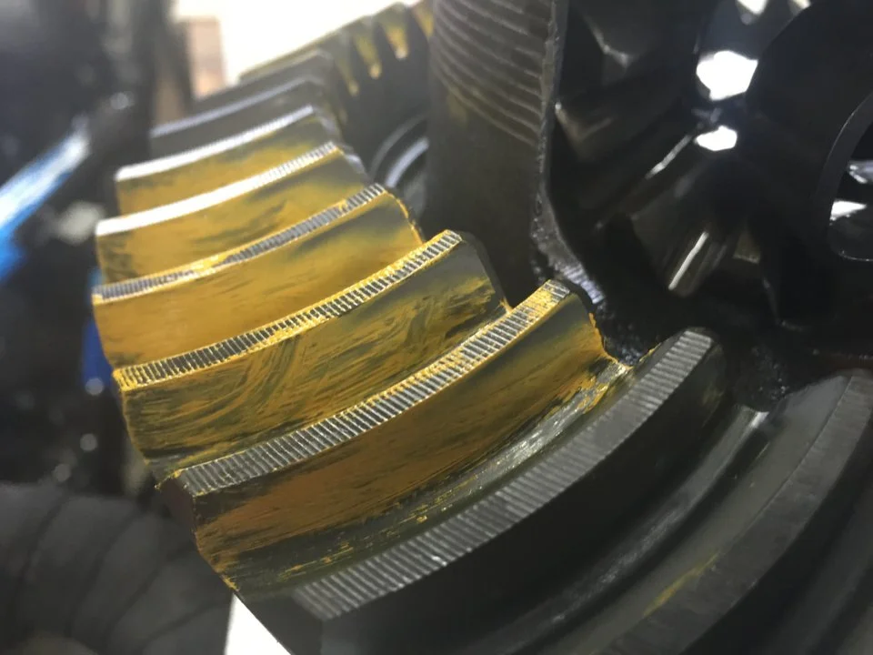

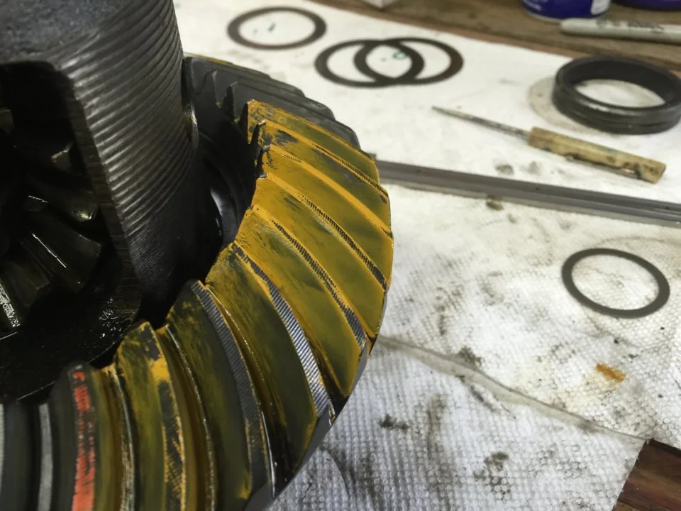

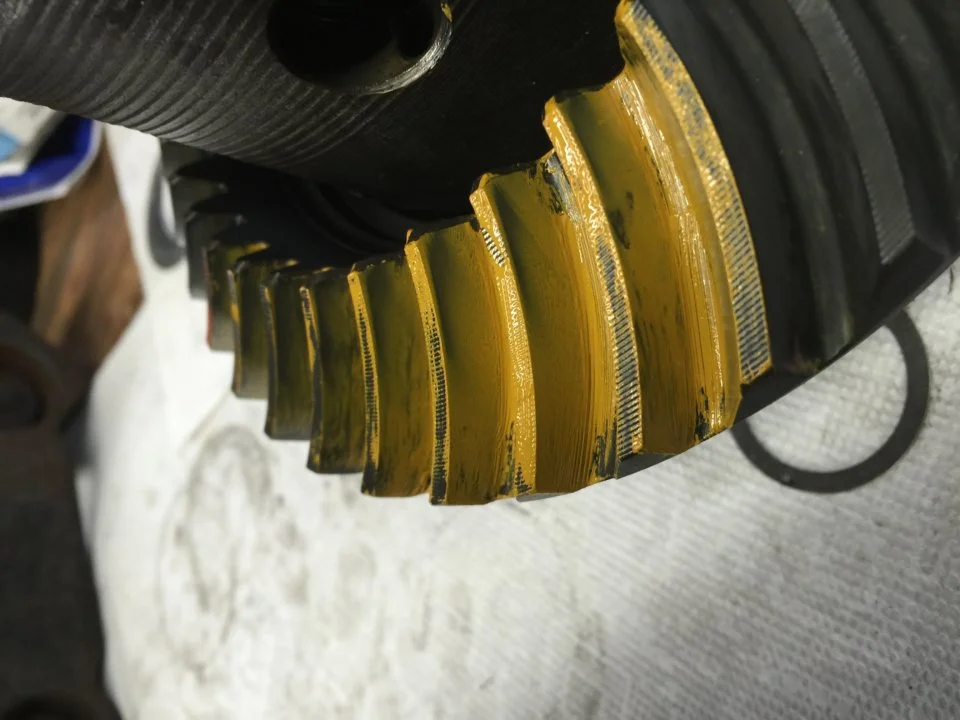

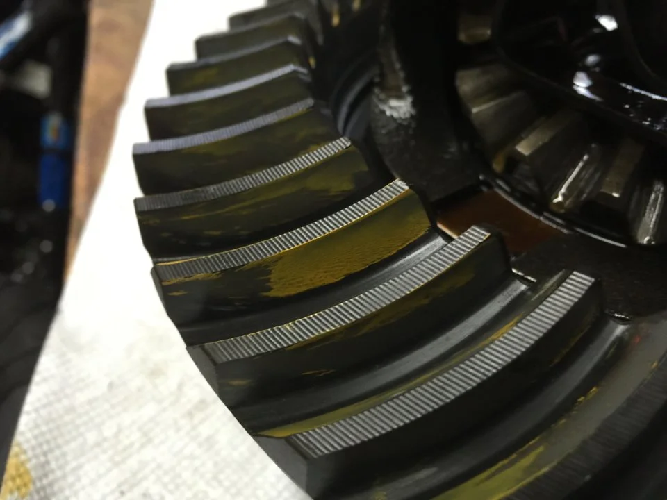

doing my first gear install and have jumped many hurdles but feel like I am doing the job right and it should be done soon hopefully. I have my backlash set at .009-.010 my preload on my pinion bearing is 17-22 depending on how you read the jumping needle. the only thing that takes a experts eye is the gear pattern. I have printed out a bunch online images but would really appreciate someones opinion on what they think it looks like. hopefully it is good so I can just put it back together and call it a day.

From what I've seen in my research I don't think it's supposed to be that solid looks close though

Pinion depth might be a hair shallow
By shallow you mean add some shim to it so that it goes deeper into the ring gear right?

Usually measuring pinon depth is done from the back side of the housing so shallower would mean less shim so the pinon sits deeper in. That would be my judgement of your pattern. There is heavy contact at the toe of the drive side and the heel of the coast side. Any time the pattern is opposite from drive to coast sides, you need to adjust pinon depth. Get that right first, then fine tune the backlash.
This is what I was trying to say @adumb. What size shim do you have between the pinion and bearing now? Are you using ford gears?

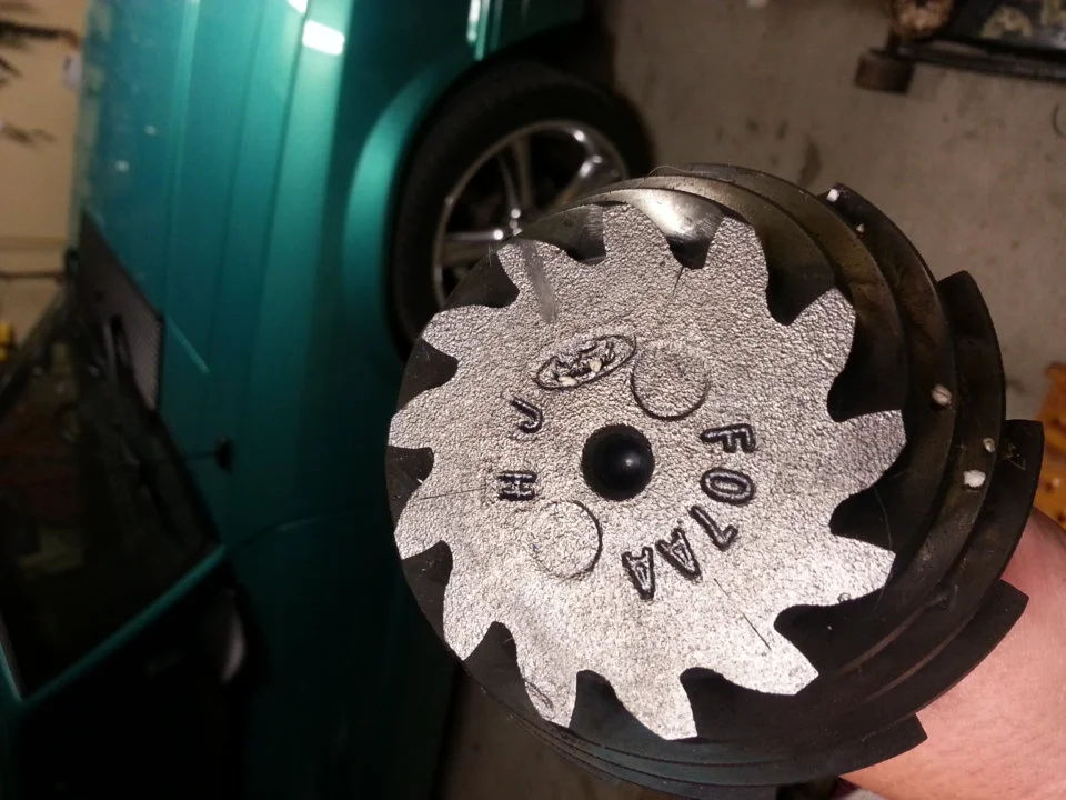

See this?
That's the pinion gear out of the car in the background. Note the face of the gear is rough and unmachined? Most companies use the face of the pinion as a reference to set pinion centerline. They are also smooth machine finished. That's what the fancy tools you see in jegs and summit are used for. Ford doesnt do that, otherwise that face would be machined so you could measure it precisely with a depth mic or an indicator jig. Instead, they machine their gears for whatever reason with the backside referenced .030 off the bearing. I don't know why they chose to do this, but every single 8.8 with ford gears I've ever worked on or inquired about was set up this way. If you stray away from ford gears you'll need to set centerline but otherwise stay as close to .030 as you can and you'll be in good shape.

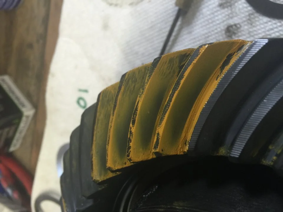

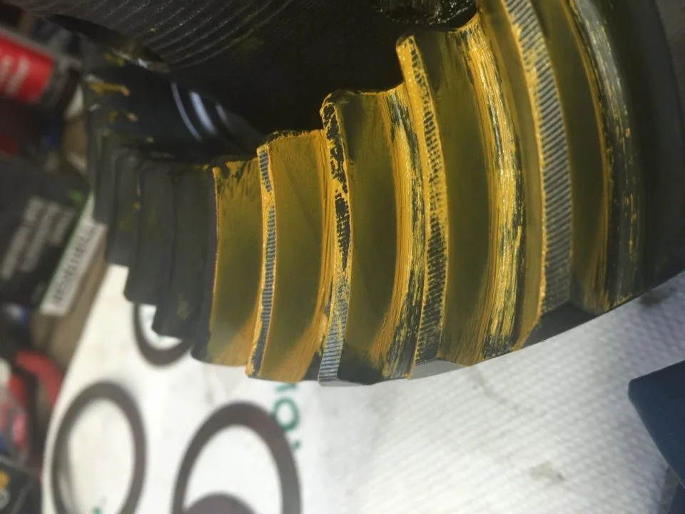

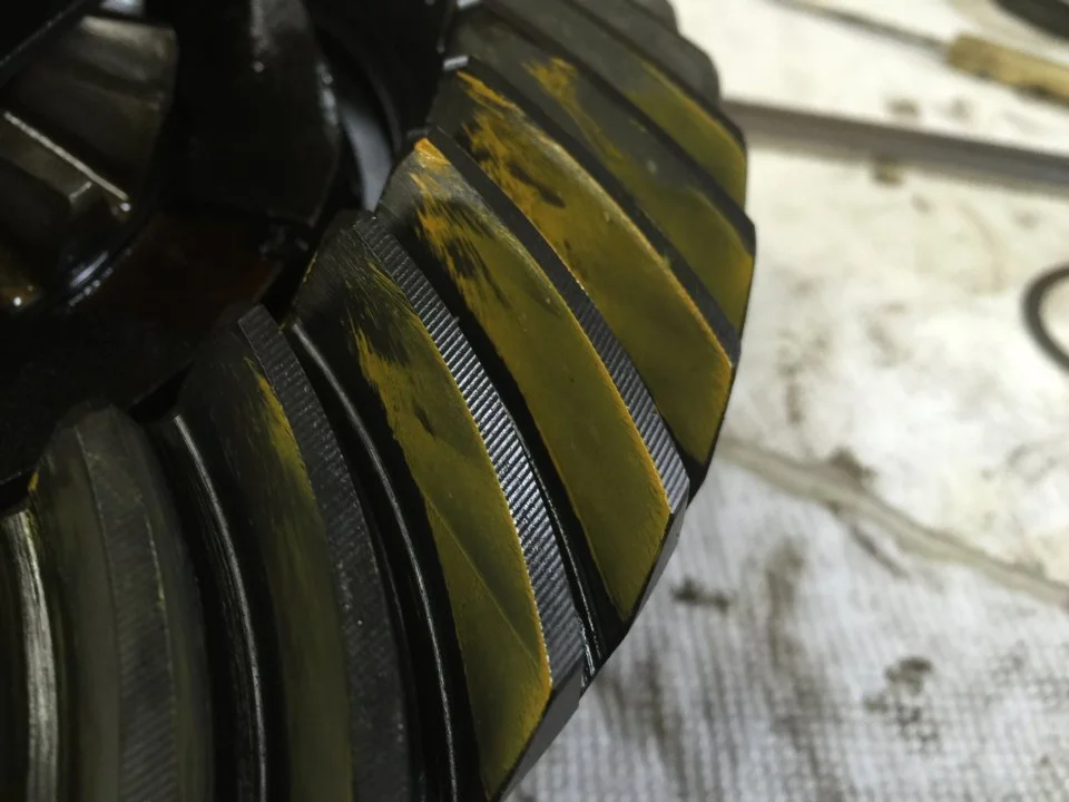

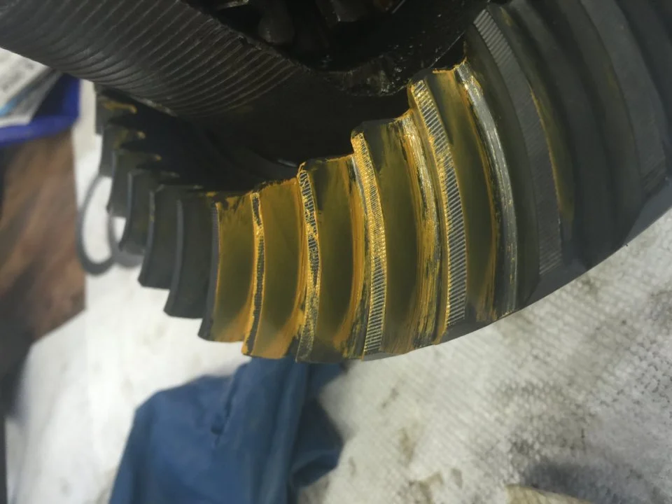

My new pics. Backlash is .011-.012. Looks like it isn't as heavy on the heel toe which is what we were looking for. What do you think?

needs to be between .009-.010 where you are right now your gears will be noisy.

Backlash is .010 seems to be on the edge on both sides now.

I'd run with that

Backlash is .012 pinion shim is .034. I think this one is by far the best but I also don't know what I am looking at. I am going to tighten up the backlash and take more pics
