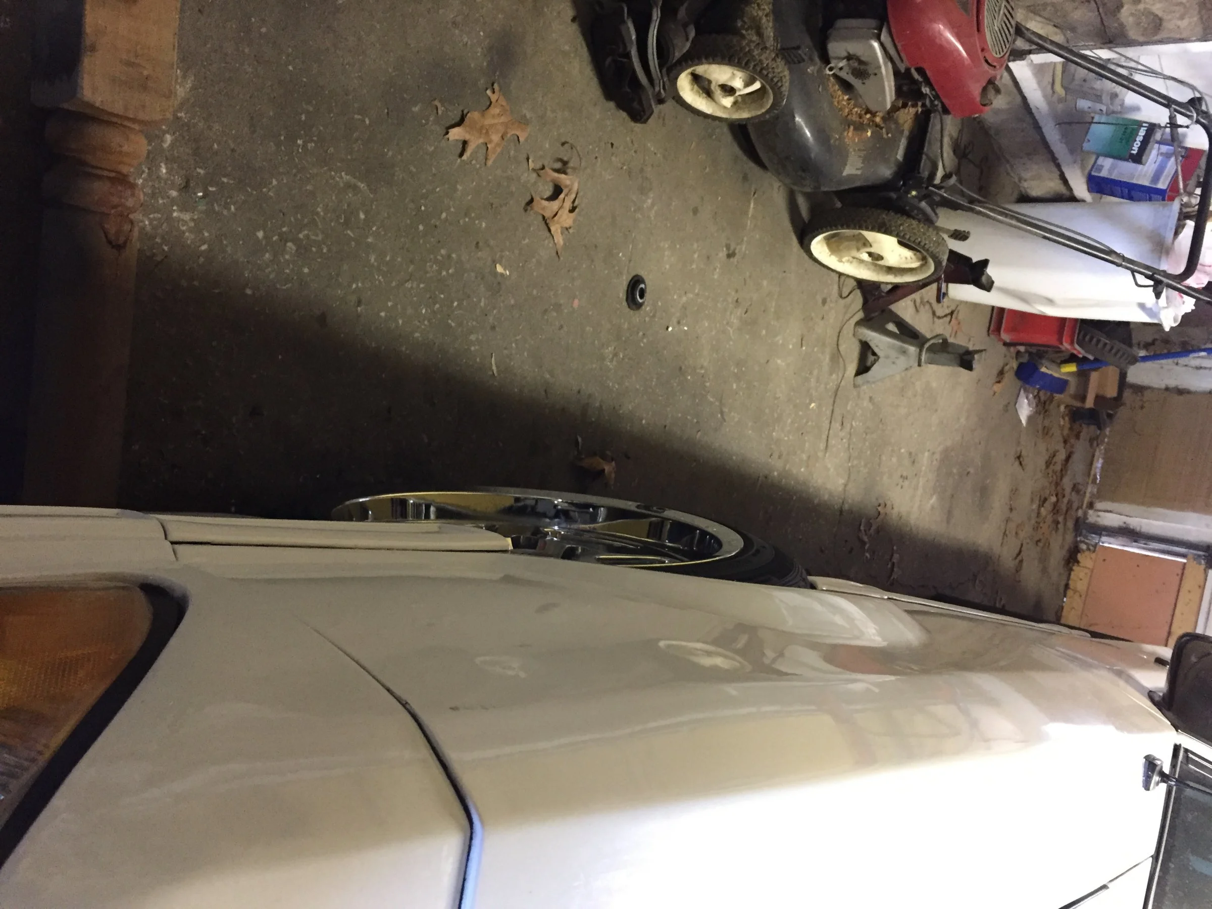

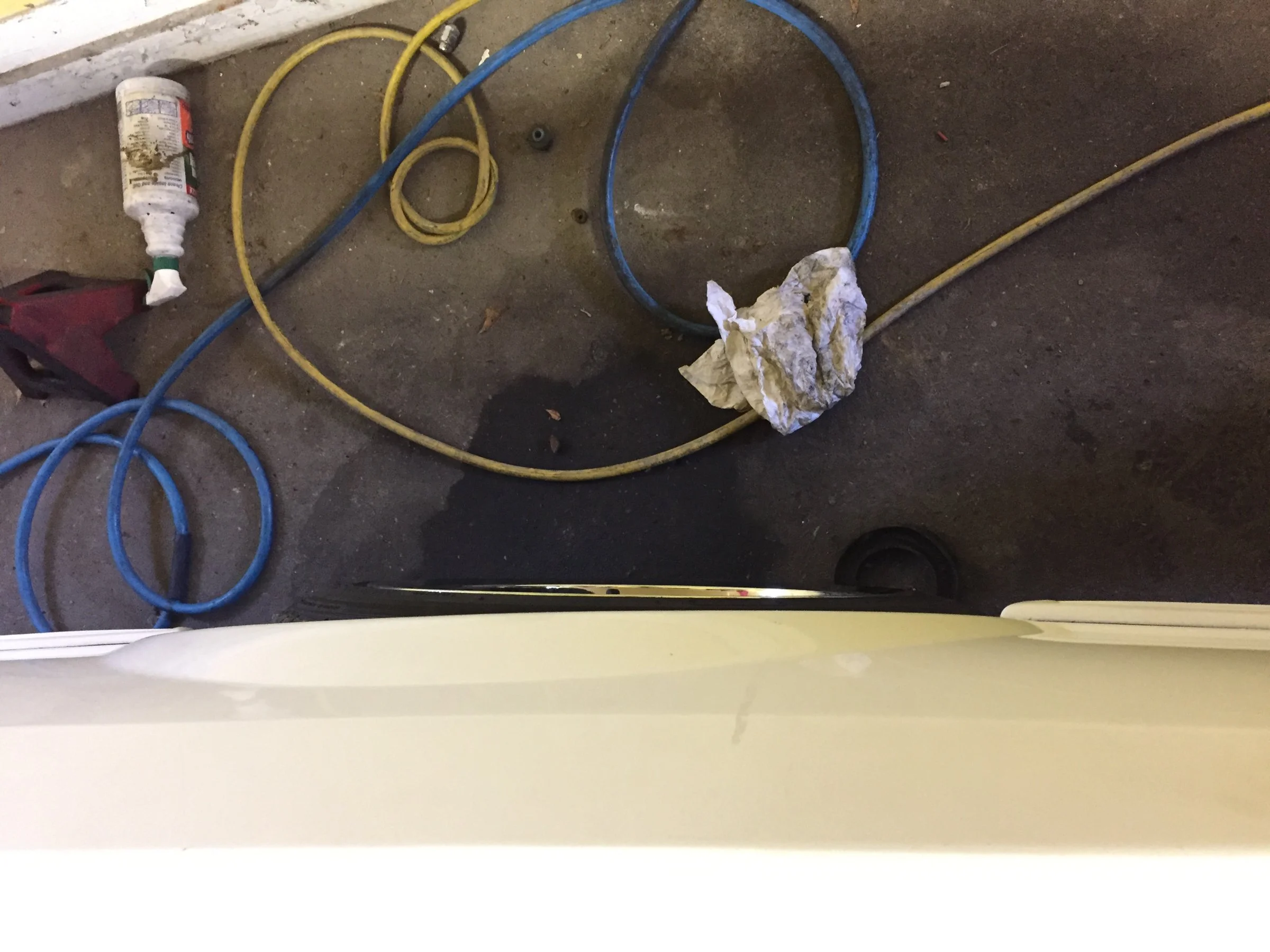

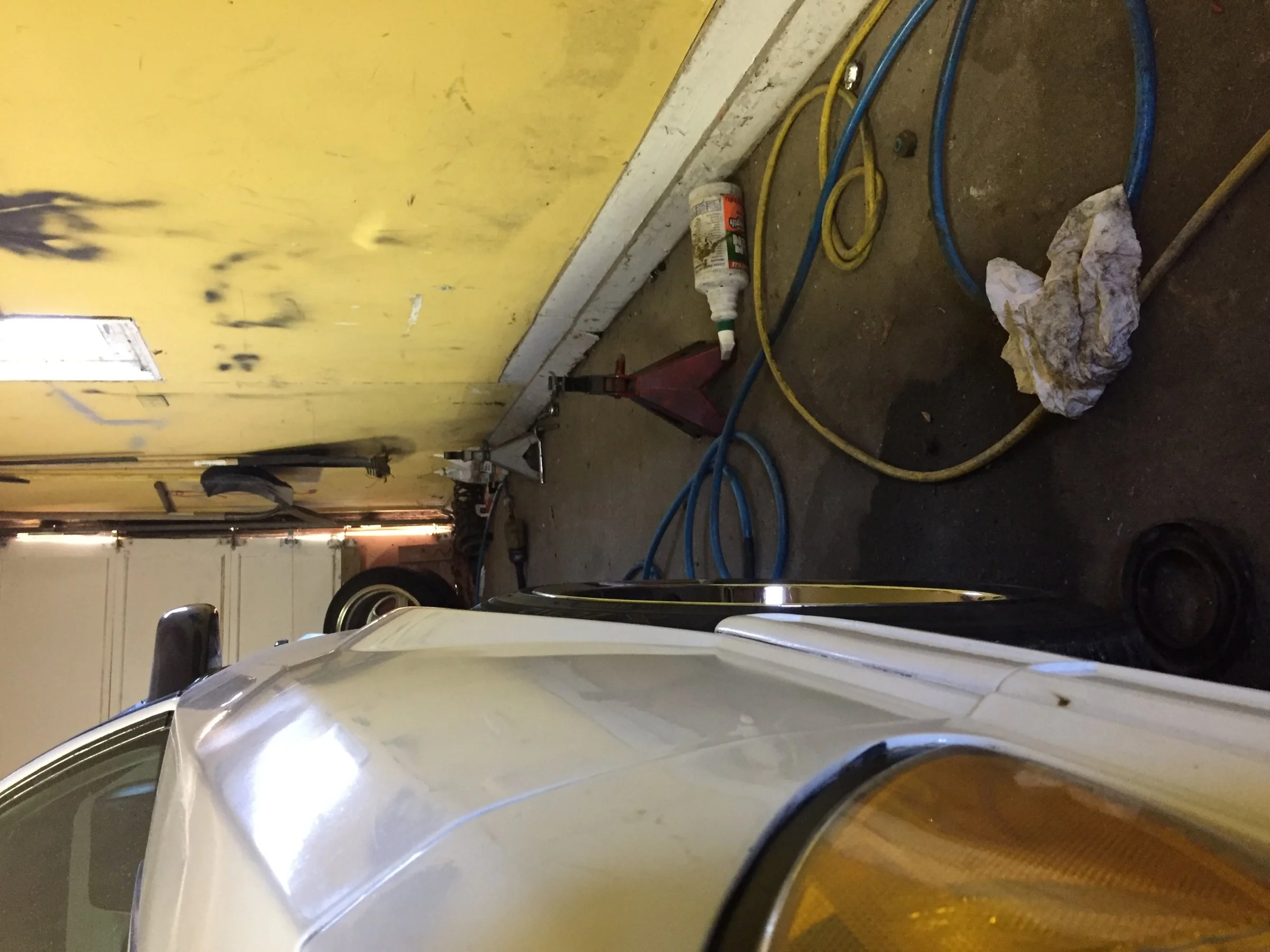

Ok, I know pics won't help much, but it looks like drivers side is slightly toe in and passenger is really toe in.
Drivers side ( ignore the mess)

The toe is common. Just has to do with the location of the tie rod arms on the SN95 spindles. You just need to adjust the tie rods out far enough to get the wheels straight enough to drive to get an alignment. Mine were both toe in when I did the swap.

But yea, toe will cause the car to handle like crap. Just push that tie rod out some to try and straighten it out a bit. Just make sure you have plenty of thread engaged into the tie rod at it's final position.

It's pretty easy to get very close on toe. Take something straight (2x4 or similar) and push it up against the outside of each front wheel. Use a tape measure to measure in front of the wheel and behind it. Adjust until it's where you want it to be (a little toe in, around 1/16" closer in the front). Eyeballing one of them and calling that one the straight one is fine. It gets you very close so you can drive until you get an alignment. Significant toe out will suck to drive, it'll feel like something is loose in your suspension. Car will drive along, then suddenly lurch. My race car was making a popping noise when that happened also, might have been pulling hard on the sway bar or something.
