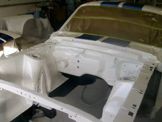

I stripped mine with a pump spray bottle of cleap lacquer thinner and steel wool. The factory paint is very easily wiped off with a minimum of effort. Once the paint is off, I sanded with 80 grit to give the steel some "tooth", then hit some of the low spots with filler, sanded it, primed and shot it body color, but you could just as easily paint it with semi gloss for a more stock look. I do recommend removing every single part and wire you can. Wiring and brake lines are a PITA to mask around and easy to remove.

Wow that turned out nice. Wish I had the time, money or know how to paint mine body color and have it looking that good. Car is black so as long as I go with a good looking semi-gloss of semi-flat I think it will look alright.
