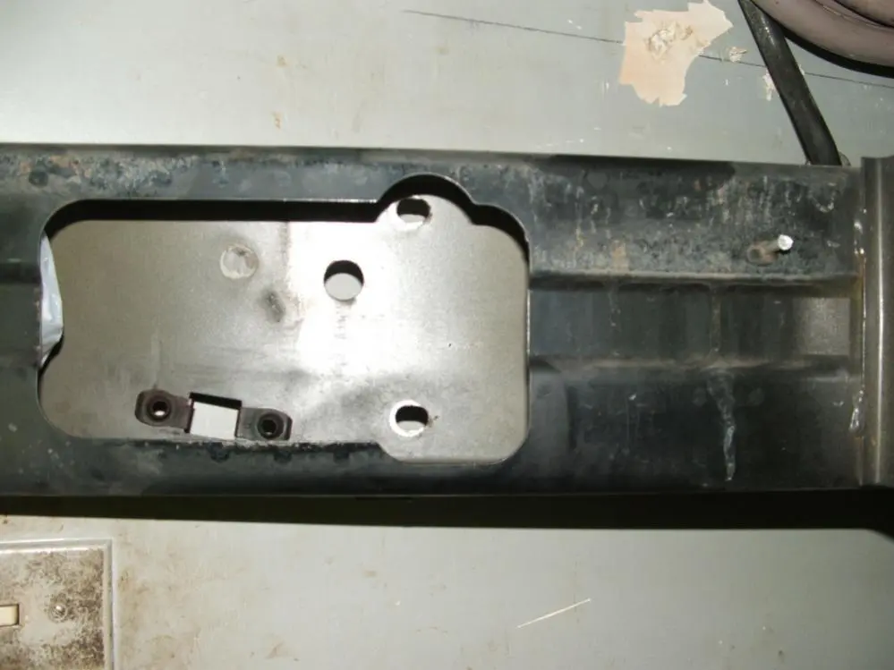

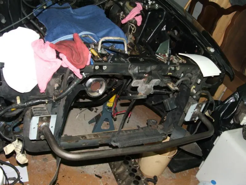

the bumper support, i just changed mine to a racing light weight bar and it's easy to take the stock one off.
on the ends you should have a foam piece on both sides that easily comes out. behind that there is 2 bolts on both sides. i'll try and get pics tonight of the stock support off the car and show where the bolts are.

Nate ~ heres a pic of the stock bumper support off the car once the foam front is removed. it's just a pic of the left corner. in that window you should have a piece of foam that you slide out through the side. behind that there are 2 bolts, it's the same on both sides.
and a pic of the "for off road use only" bar.
hope it helps.
