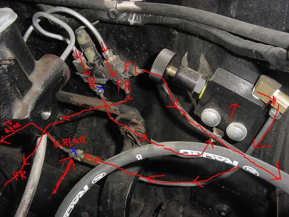

Here is a cheat sheet for you:
the summit brand prop valve is quite a bit less money than the wilwood.... it is like 35.00 iirc. i used one on my 65, and it works just fine, just set it at the midway point (count total number of turns in, then back it out half of that) to get you started, and adjust from there.
