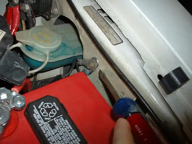

If the voltage drops sharply bebore the engine dies, this may be your problem. The secondary power ground is between the back of the
intake manifold and the driver's side firewall. It is often missing or
loose. It supplies ground for the alternator, A/C compressor
clutch and other electrical accessories such as the gauges.
Any car that has a 3G or high output current alternator needs
a 4 gauge ground wire running from the block to the chassis
ground where the battery pigtail ground connects.
The 3G has a 130 amp capacity, so you wire the power side
with 4 gauge wire. It stands to reason that the ground side
handles just a much current, so it needs to be 4 gauge too.
Picture courtesy timewarped1972

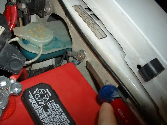

Where does the other end of the ground wire shown goes???
