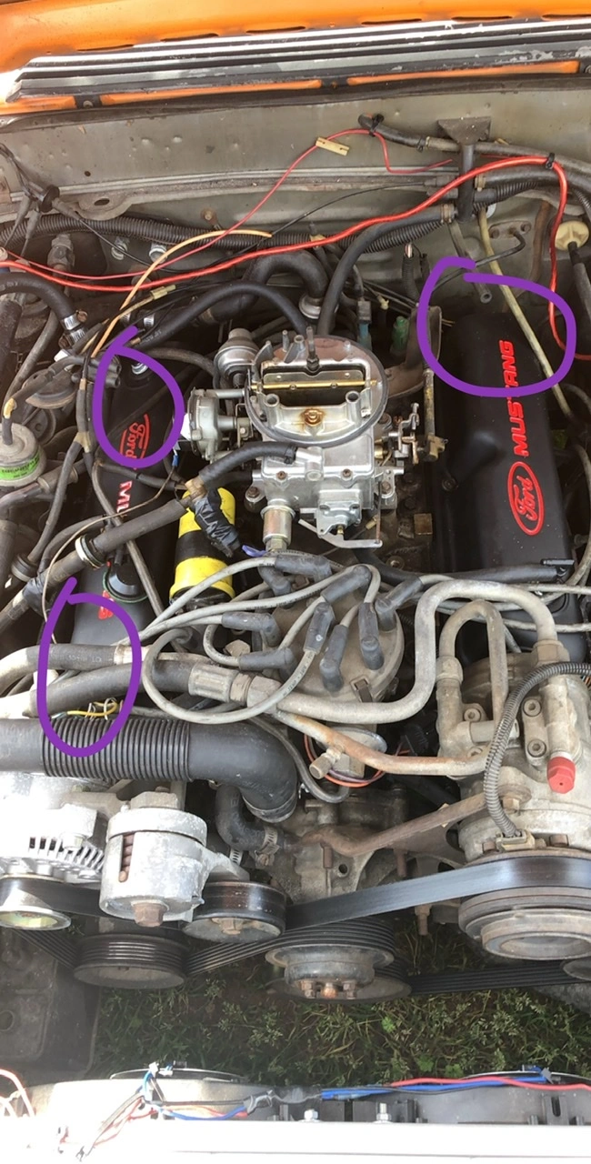

Help! Mystery oil leak
First off I have looked through a lot of post about oil leaks that are similar to mine yet not the same, the oil is coming from somewhere under the valve covers but not leaking from the valve covers. Also not in one spot seems to be on the passenger side front and rear and driver side rear of the motor. I also think that I have excessive crank pressure but not sure if it’s connected to the leaks.
No smoke out the exhaust
No coolant loss however I have started to notice trashy looking pieces in it
No oil around rear main seal
Any thoughts would be greatly appreciated
If I'm seeing what I believe I'm seeing, you probably do have excess crankcase pressure. It looks like you've got two PCVs and no breather, which will cause that. I'd ditch the driver's side PCV and put a breather there, and cap off the vacuum port on the carburetor. As far as the source of your oil leak, it is possible for a 302 to push oil past the end seals on the intake manifold when the crankcase pressure gets too high (especially if still running the cork pieces and not the rubber and/or RTV). I'd take a look there.

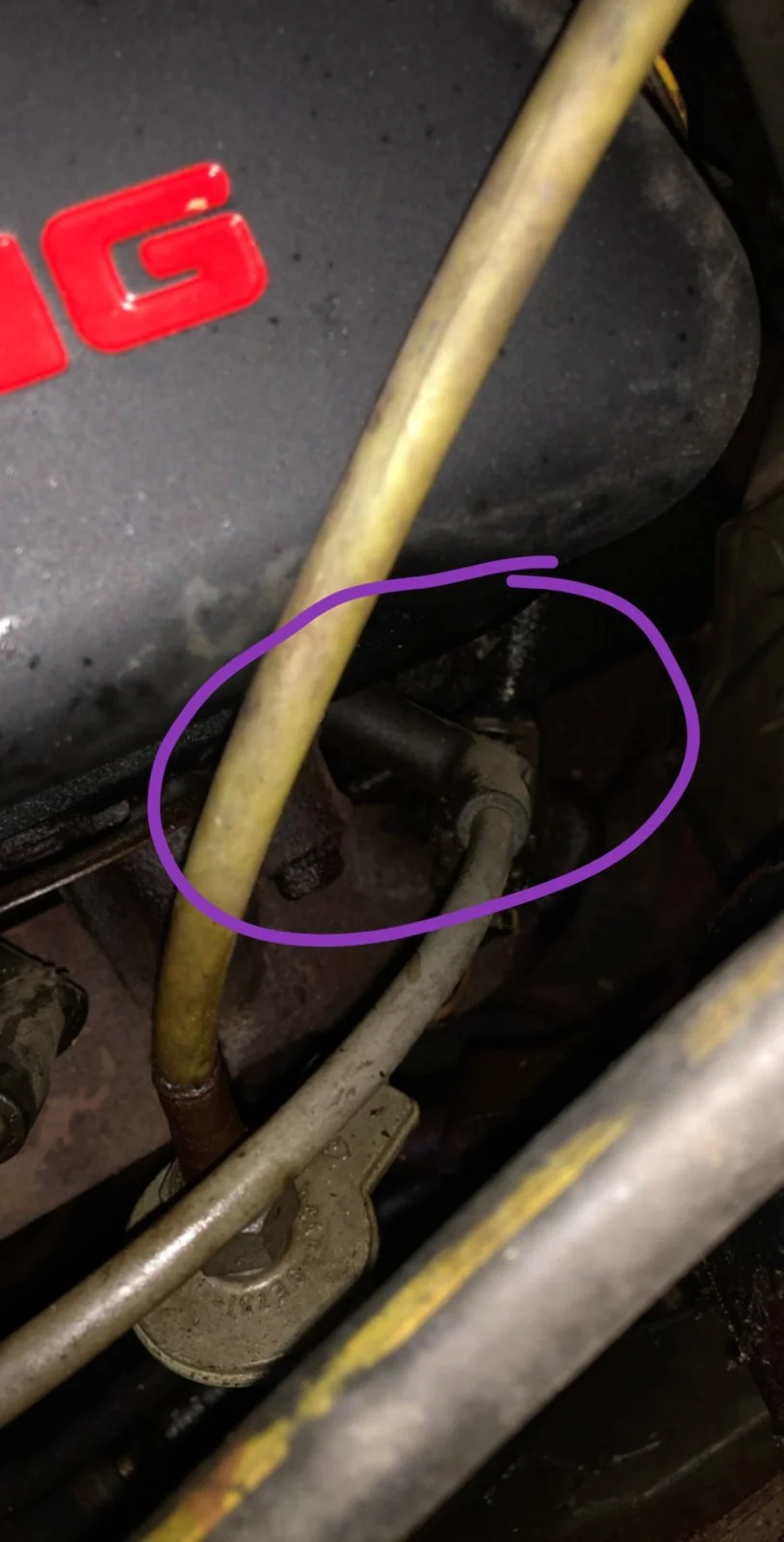

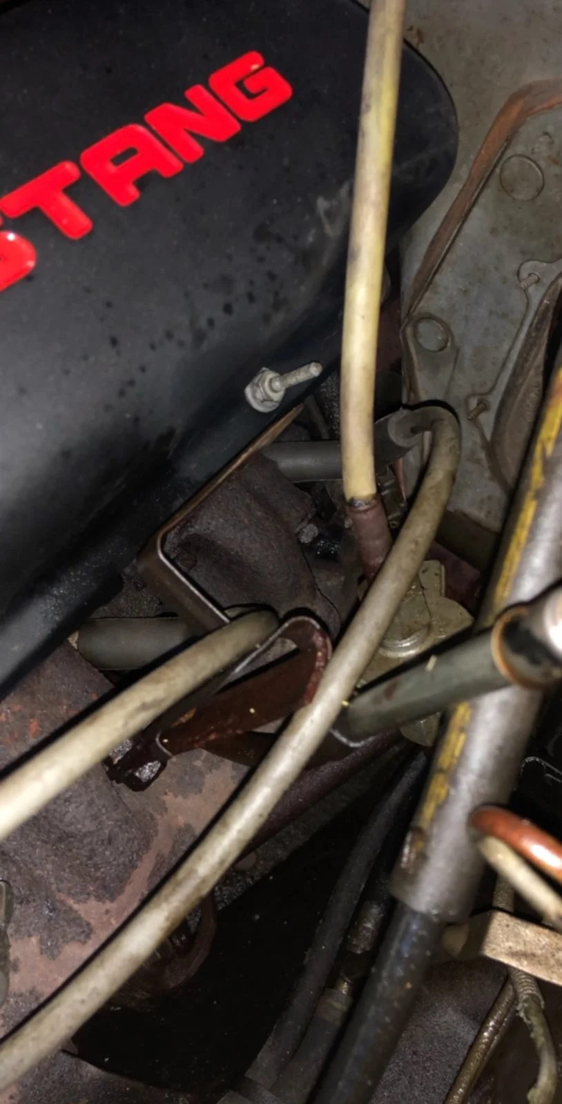

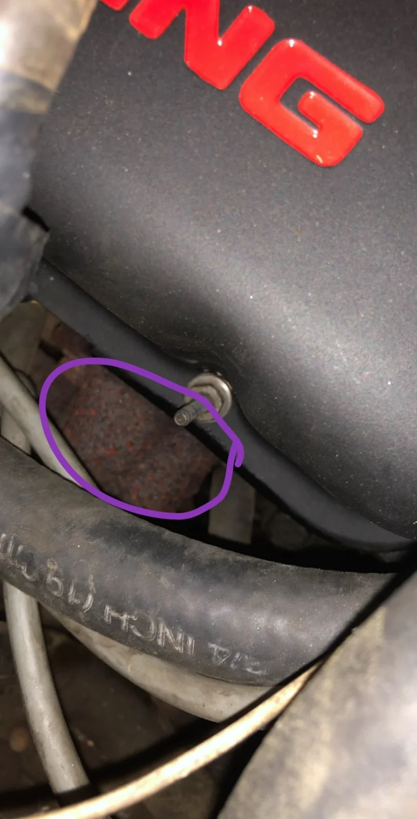

These are 3 pictures that show where the oil is burning at, I don’t know where it’s coming from to get there though. I have jacked it up and looked under still don’t know where it’s coming from
