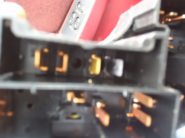

ok last night i went to the park with my girl and when we were leavin i turned on my lights and all i had was park lights, checked all the fuses and nothing bad, but when i pulled the turn signal lever back my high beams would come on so we figured it was the switch so i pulled it out and bypassed it with some wire and had lights to get home. and my dad picked up a new switch today from advance and we plugged it up and nothing, dont even have parkin lights now but they still come on when u pull the turn signal lever back. any idea whats goin on??

when playing, something to check. if the feed from the hdlt switch to the multi function switch (i think it is red/yellow, but not sure) backs out of the harness at the MF switch, you will have no feed from hdlight switch. the flash to pass still works though (as your did).
just something to remember if all else fails.

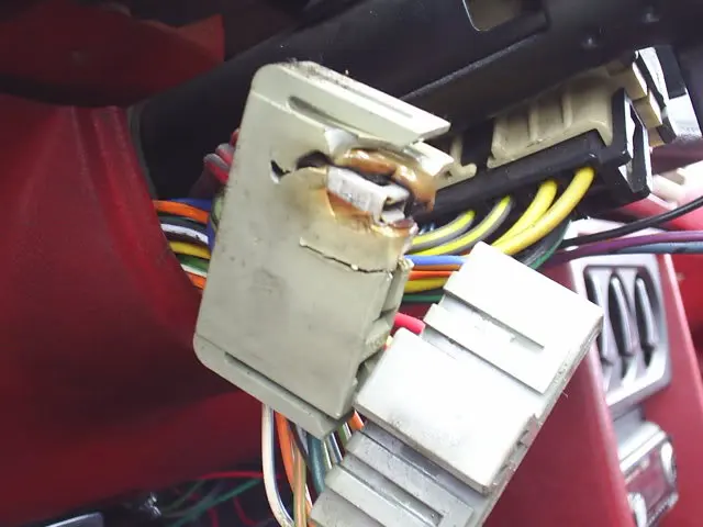

same thing happened to me, except the previous owner wired the headlights to a pole switch and a fuse to the battery...had wires everywhere.....turns out the car had the foglight problem and it burned the multifunction switch...got one at the junkyard for $14 and all is well.....
