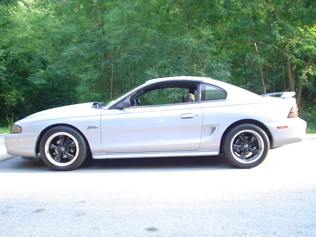

Well Saleen doesn't make their springs. I heard that Eibach makes them and they are comparable to the Eibach proline kit painted red and with saleen/racecraft markings. Ive had both on my car with the saleen's on right now. The guy that installed them said that they were a tad bit taller than the prolines. I like the ride better with the saleen springs, but if your main concern is bottoming out, just make sure you are running a good sized meaty tire like 255-40's or 265-35's. I have saleen 18X8.5's with 265 35's all the way around. Eibach would be the way to go and if you can get a set of Saleen's that would also be good too, but Saleen is not known for their timeliness of shipping of some of their rarer parts. Oh and if you order through saleen make sure you reiterate to them that its for a vert or coupe since the rear springs are different between the two. If you can afford it, try and put some shocks and struts at the same time. I just recently put on low millage "take offs" along with the new saleen/racecraft springs, and new shoes for the rims. I haven't had a better ride. The drop is about 1.25 for the rear and 1.5 for the front. Got any pics?

Back is just a little lower than shown in this pic now that all is settled.
