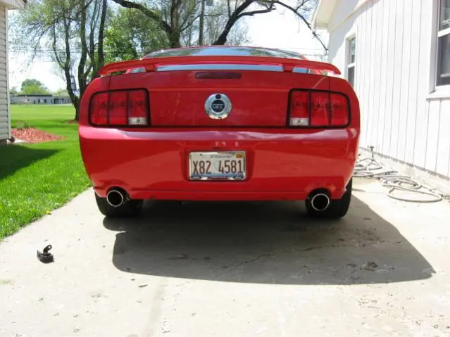

The problem i am having is i am too anal and there is a slight imperfection when it comes to alignment. I have gotten my ass under there to fix it to no prevail. I have asked everyone i know and they have no idea ( no surprise there). I had a post last year around christmas when i purchased the pipes and someone said the hardest thing is to align the two lol.

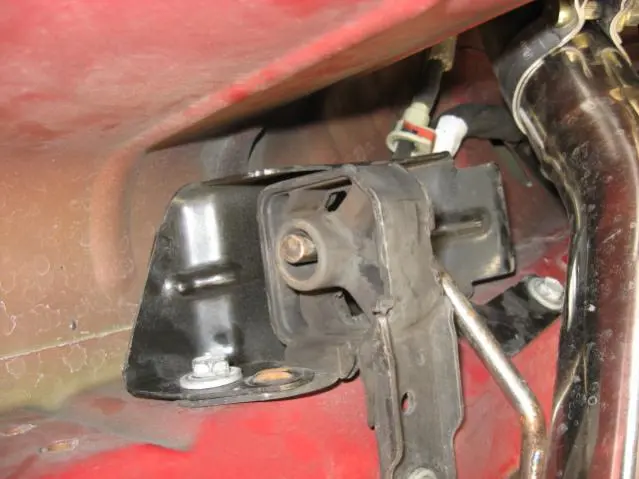

Anyways going to post some pictures. If anyone knows anything i can try please let me know. I do notice on the driver side pipe there is a different looking bracket with some kind of guard on the top. I am wondering if maybe i should change that out with a different type or not.

Most of the time you can fix the alignment of the exhaust tips by bending the hangers on the mufflers themselves. You may have to remove the cat-backs off the car to bend the hangers enough to do it though. Spend a couple hours fussing with it and you should be able to get it just right.
if its not perfect, i wouldnt worry about it. as long its not touching anything or getting any vibrations, its good. this is a ford after all, not an italian sports car. ive seen stock exhaust that doesnt line up perfectly.
wow I've seen most times the left side being down too far then the right. That's what happens to my car. I move the tip and then it loosens itself down to whatever position it's comfortable with. I gave up on it.
