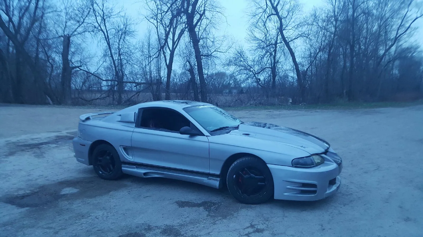

I have a 94 gt with the 5.0 ho motor. It runs great but end of last summer started to spit oil out of dip stick. I replaced the pvc line and it's still doing it. Any suggestions as to what it could b or what I could try next to solve the issue?
