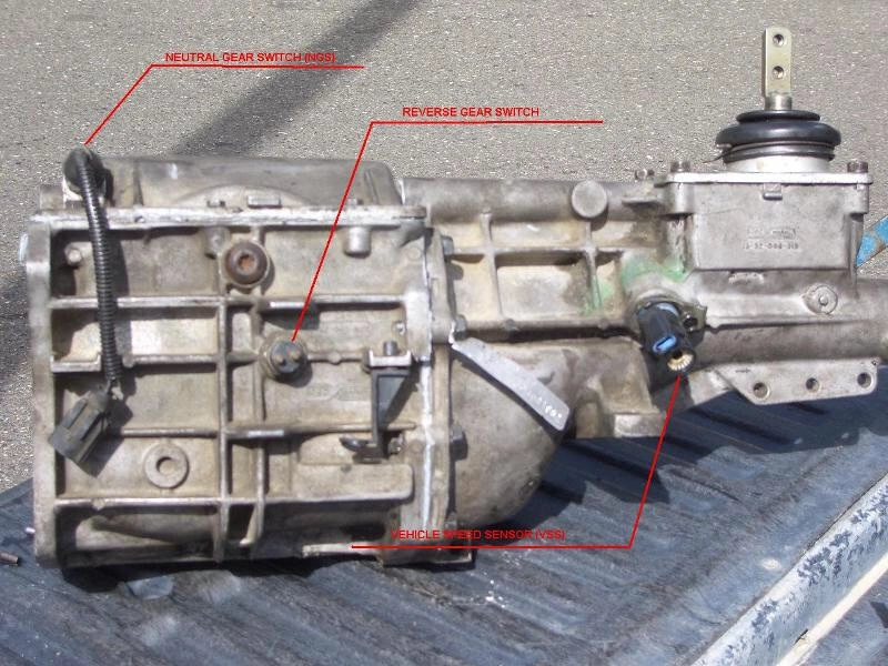

Hello all,just recently bought a 02 gt 4.6 and the dude said the clutch was bad so ok I replaced the clutch plate and pressure plate,car still doesn't go into gear, lost at what it could be really any ideas would be appreciated
Retrace the steps.
  1. Why did you chose to replace the Clutch in the first place? (Diagnosed Correctly?)
  2. Did you reconnect the Neutral Safety Switch?
  3. Did you replace anything else? (throw-out bearing, clutch fork, shaft, fluids)
  4. When you put it all back together, did you mind the proper torque?
  5. Recheck that damn Safety Switch
  6. The Clutch Cable, Did you seat it fully at the fork?
  7. The Clutch Cable, on the firewall is it adjustable or fixed?

Went out while just on the free way clutch just wouldn't engage goes into gear when off,where is the safety switch located? And yes new clutch cable I used the clutch petal to let it set itself
