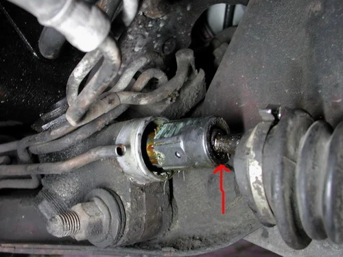

i've put away the boot and found play on the ball joint at the beginning of the inner tie rod ( where i made a red arrow on the join picture )
is ti normal that there is play here ? i don't think !

Yep, that is your problem then.
All you need is the inner tie rod, that is all one piece in there. Just make sure you take care of the rivet/set screw before you try taking the old inner tie rod off!
And yes, that part you show is the one you need, before you buy it check the other inner tie rod & both outers, as well as the ball joints, for excessive play. That way if something else needs replaced you can order them all together.
