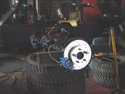

I thought the same thing, till this was going in:
And yes, I know some of you will say the rotors are on backwards, but I'm not hard on my brakes so I mainly got them for the looks and I think they look better this way.
Yeah, that's also what I thought, but I have had a lot of people tell me they're on backwards and that the slots should vent the gasses inward not outward.
There are no gases to vent...unless you are running exotic race type pads.
The slots are to wipe brake dust off the face of the rotor/pad as the rotor moves through the caliper. What direction they face does not really matter.
Crossdrilled holes are for venting gases, but like i said before, unless you are running exotic type race pads, there are no gases to vent. Either way, there's nowhere for them to go if there were gases. The gases normally would vent into the center vane area of a vented rotor where the main airflow of cooling takes place. since solid rotors don't have the internal vanes, there is nowhere for the gases (if any) to even go.
Basically they are for looks..so run em whatever way you want.

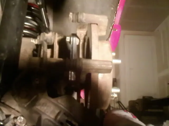

so what a waste of money. 160+ and the damn things still don't line the caliper bracket up correctly. I had to use two washers to center the bracket. Here is the pic and you can clearly see the bracket was touchin the rotor before i added the washers
I told you that you were going to have to do that. I am not sure why they designed them that way. Also, the rear calipers are the same on Gt's and Cobra's. The only minor difference is a small cross member going along the front of the caliper.
yeah, i'm kinda pissed that there that much and they still can't correctly design them. i guarentee those things don't cost but 20 bucks to make and bend, then drill the holes. i wish a no name company would take this on and sell them for 60 bucks, that'll put North Race car in the place
I had to washer them too.
Didn't think much of it. No other choices out there.
Also there are many companies that do not wish to be involved in brake components. It would seem there is alot of liability involved should something go wrong.
So while i too didn't love 160 bucks, there isn't any other choice.
Besides, if they didn't fit in the other direction, you would have to have them milled to fit, so washers aren't the end of the world.
I beleive the washers are needed by design. If you use Grade 8 hardware or better, it shouldn't affect anything.
I beleive the reason was production variances for the gap with factory caliper brackets. I don't want to speak for NRC though, but i think that was the explaination i read on corral.net??
