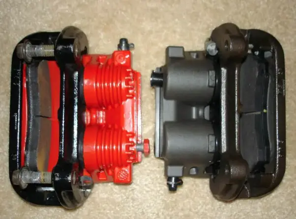

Front calipers are easy to disassemble/reassemble. Just make sure you ID your caliper as the 94-98 or 99-04 version of the cobra caliper. There are piston size differences so the seals are different. Vast majority out there are the 99-04 version.
Best way to tell is to peek underneath if you aren't sure. 94-98 will have ribbing on the piston cylinders(left caliper). 99-04 will be flat (right caliper)

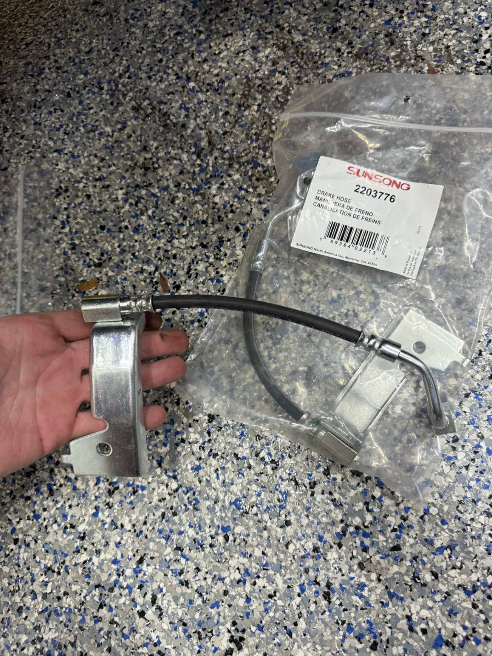

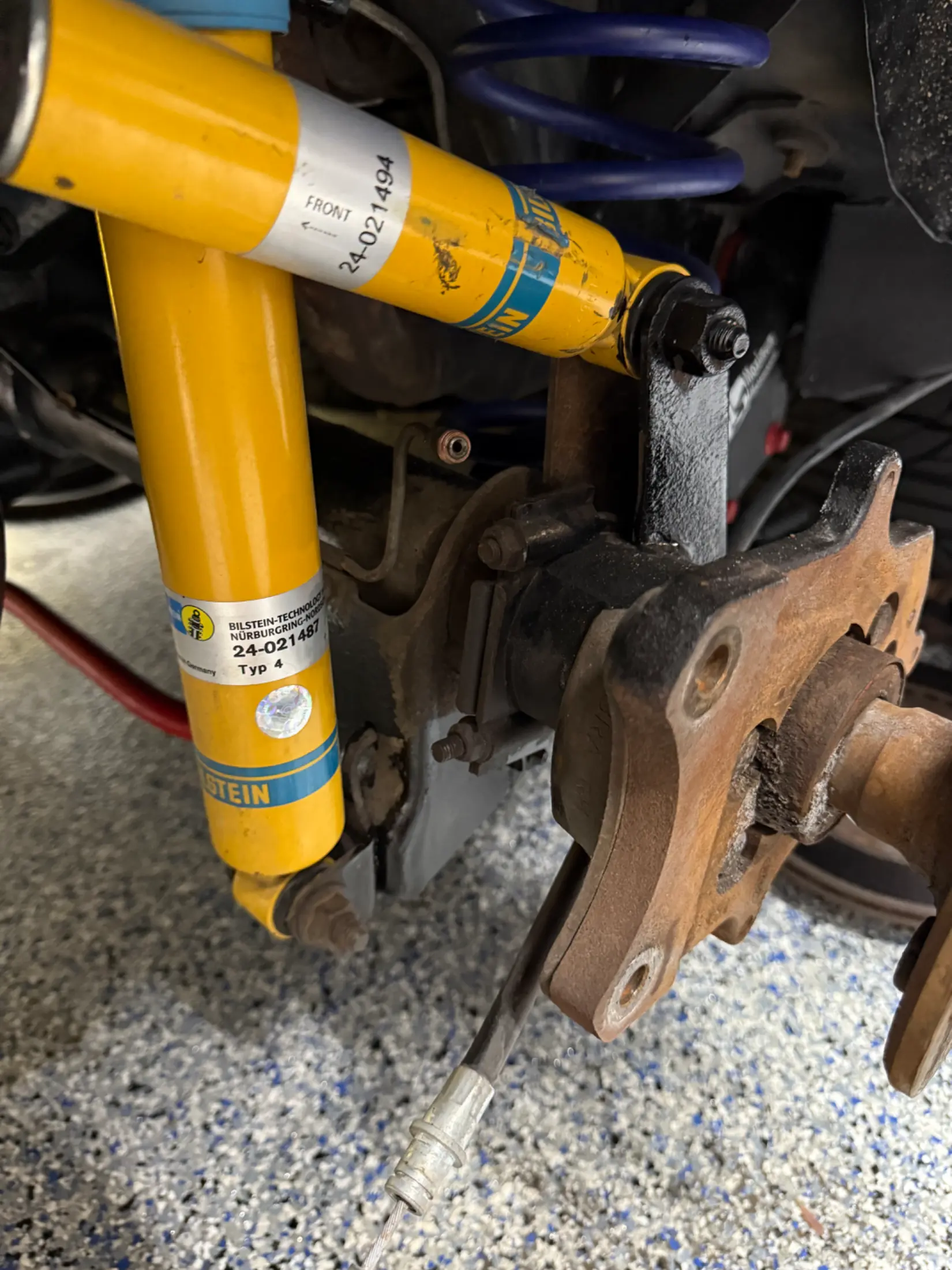

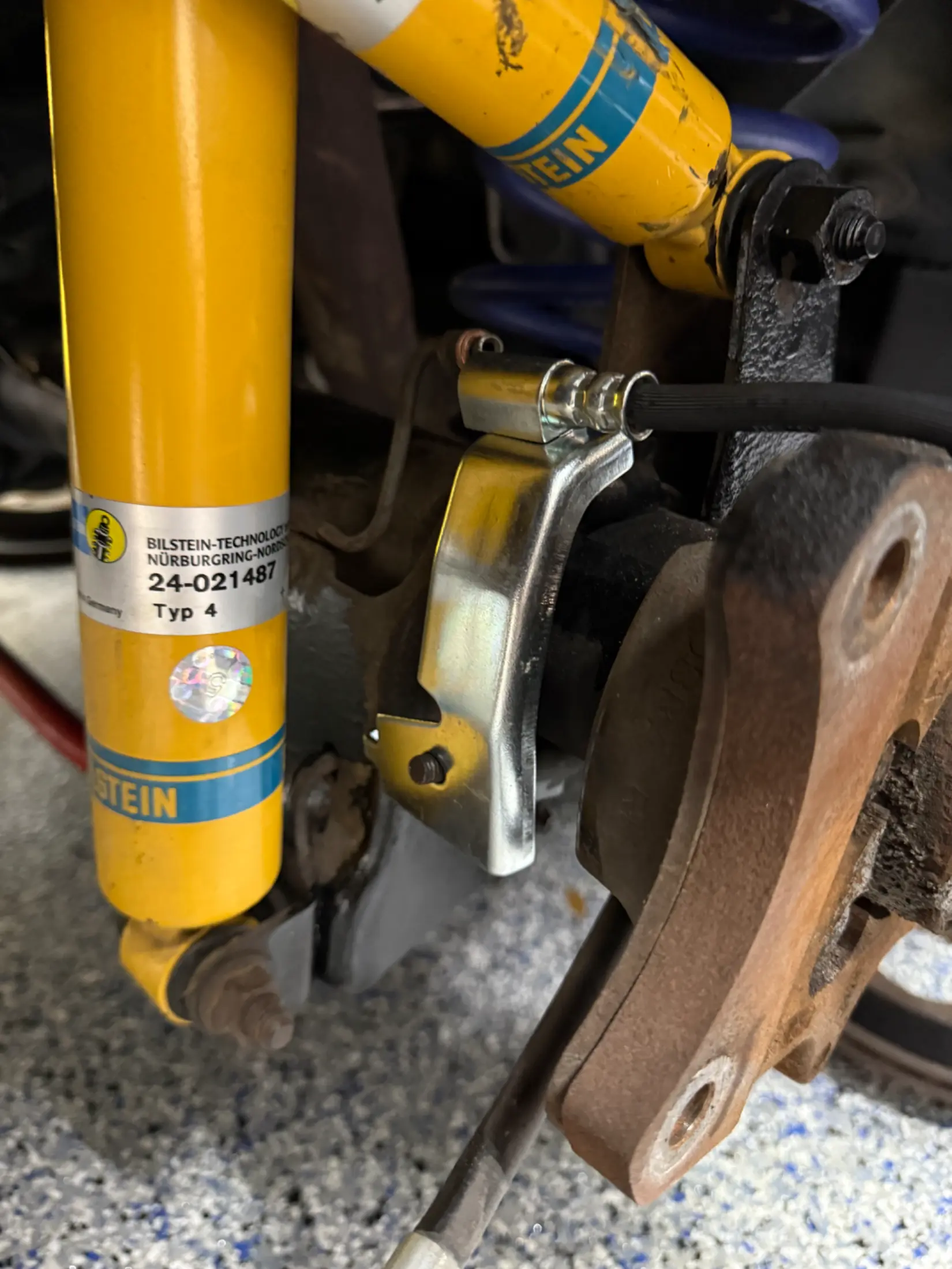

How are the rear brake hose brackets mean to attatch? Mine don’t really line up with anything… Someone had previously just jammed the bracket hole into the brake anti moan bracket stud.
Do I even need the bracket can I just cut it off?
