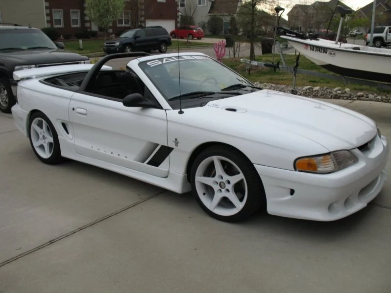

I have a 95 S351 that came with the Lemans style wheels. For my birthday my wife ordered a used set of speedline mags that were powder coated white. I had them re-coated to freshen them up. The fronts are 18x8.5 and the backs are 18x10's. I had KWD 2's mounted with a touchless machine so they didn't get scratched up. So at this point I am out about $3800. I got off from work early, jacked the car up, and tried to put on the new rims and tires. This is where I noticed an issue........the lug studs are to short for the inserts on the mags. I was able to get the backs to mount but I am not really comfortable with the number of threads I was able to get on the lug nuts. I was not even able to get the threads to catch on the front. What's the fix? New inserts on the mags? Longer studs? Please tell me this is a common problem and there is an easy fix.....I am going to go broke getting these wheels on the car.

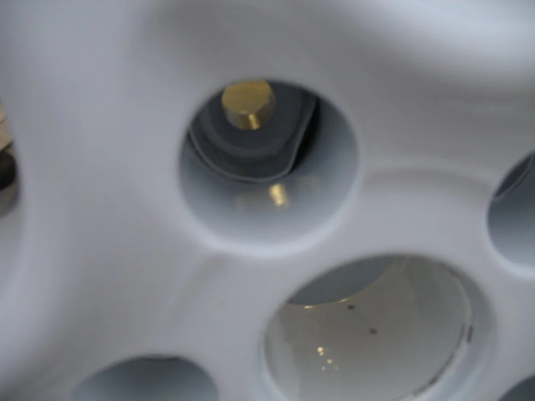

Seems to be a hard material insert that's deeper then the lemans style. Lemans are metal to metal but the mags have soem type of insert.

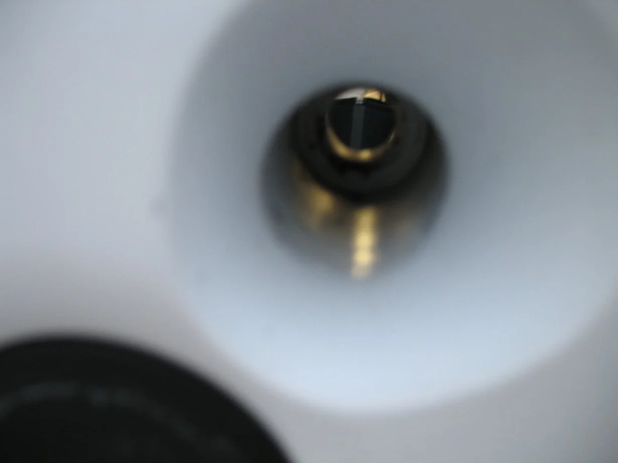

More Picutres
New Mags (deeps lug nut area)
Old Lemans (shallow lug nut area)

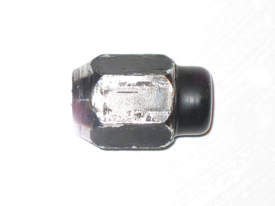

...Scott brings up another good point that I let slip my mind. Marcus can correct me if I'm wrong but I do believe the special magnesium lugs that Scott is referring too are a deeper lug hence you will be able to get more thread on the studs to tighten the wheel down. That is the second recommandation......did you buy a second set of lug nuts for the mags?? Take a picture of the lugs you have and we can tell you if you have the correct set of lugs. Also, if you can get pictures of the inside of each spoke, we should be able to tell which offset you have. You have my personal email, you can shoot as many pictures to me as you would like so we can get the wheels identified......we'll get it worked out!! Just have some more patience :rolleyes:

...on that same spoke, with the wheel dimensions, should be 35 or 10 stamped. Then again, it's not unusual for Saleen to miss details! After reading that you only got a few turns on the rears, I might want to change my original statement and go with the wrong lug nuts!! But to be safe, let us see the pictures of the wheels and the lugs.........I believe Mark @PAS has a set of lugs for the mag's, normally Joe @ Chicane has them as well or the last place and maybe the cheapest place is Cal-mustang (Scott knows where I'm talking about, that might not be the place)....
The 3 resident experts just beat me to it. The offsets between front & rear wheels are different & the magnesium Speedlines utilize a completely different lug nut than the aluminum versions.
I guess I'm sort of an expert since my '98 originally came with the mags & I replaced them with a set of LeMans wheels (courtesy of Marcus) which required me to purchase new lug nuts in a standard acorn style.
No Lugs and no Center caps......I talked with PAS and Mark is out right now but Kevin remembers something about new lugs for the mags. Anybody know where I can get the lugs and the center caps?
