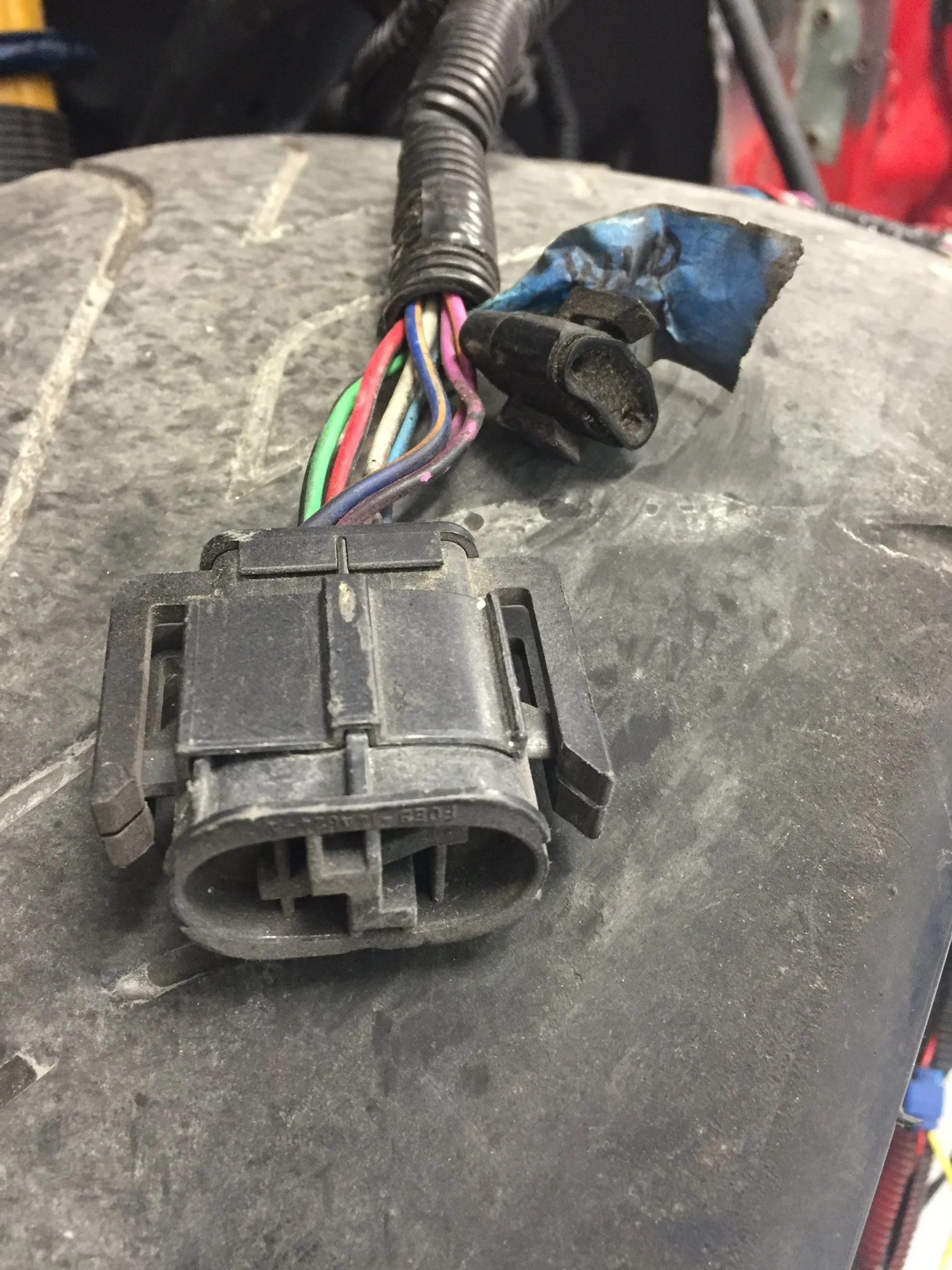

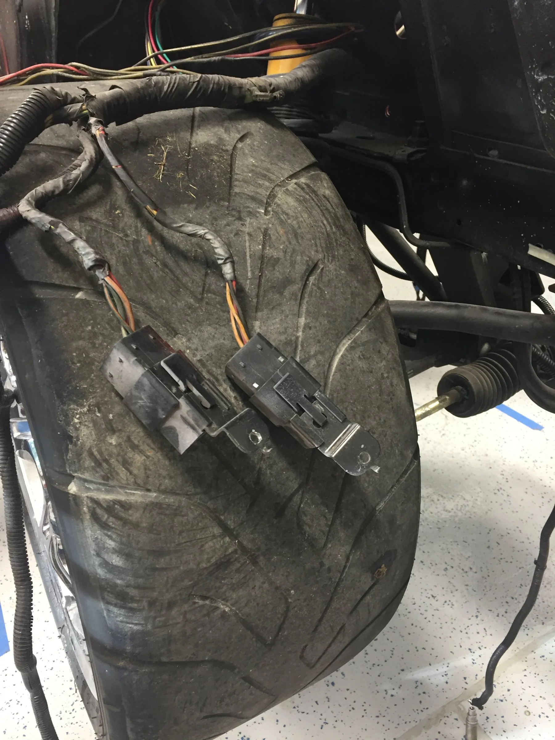

D DonMaximo Member Sep 25, 2003 217 5 19 Lewisville, Texas Aug 2, 2016 #1 Aug 2, 2016 #1 Under the passenger side fender are a pair of relays. (pic #256) On the drivers side is some kind of terminal block (pic#257) Thanks in advance. Attachments 08022016 256.webp 395.5 KB · Views: 205 08022016 257.webp 349.3 KB · Views: 192
Mustang5L5 That is…until I whipped out my Bissell Mod Dude Feb 18, 2001 43,378 18,123 224 Massachusetts Aug 2, 2016 #2 Aug 2, 2016 #2 Year of car? Wire colors? I'm gonna guess one is the A/C wot cutoff relay Sent from my big ass iPhone 6 using Tapatalk
Davedacarpainter Chicks can make things hard if they’re inspired... SN Certified Technician Nov 28, 2015 11,833 11,634 203 Discordia Aug 3, 2016 #3 Aug 3, 2016 #3 @jrichker ?
jrichker StangNet's favorite TOOL In Remembrance. Thank you for your contributions Mar 10, 2000 27,512 2,813 234 Dublin GA Aug 3, 2016 #4 Aug 3, 2016 #4 The relays are the fuel pump and A/C WOT cut off.
4G-KDMP 10 Year Member Jul 23, 2005 935 19 39 CA Aug 3, 2016 #5 Aug 3, 2016 #5 Seems like the numbers you placed on those pics for there location L & R seem to be reversed #256 is for the daytime running lights #257 is for the fuel pump and A/C WOT cut off as jrichker said
