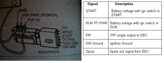

Here's some TFI tests you can try. These are for a 93 engine but I don't think Ford changed anything for 94/95.
1. Check between Distributor base and Engine block - Should be less then 2 ohms.
2. Key off, disconnect TFI connector. Measure voltage at vehicle harness connector between START and distributor base - crank engine - should be 8-10 volts
3. Key off, disconnect TFI connector. Measure voltage at vehicle harness connector between TFI PWR and distributor base - Key ON - should be battery voltage.
4. TFI connector connected - Backprobe EEC 60-pin connector at pin 56 (PIP) with DVOM or LED test lamp, and crank engine - Should have 3-6 volts or LED should blink.
5.TFI connector connected - Backprobe TFI connector connector at SPOUT with DVOM or LED test lamp, and crank engine - Should have 3-6 volts or LED should blink.
