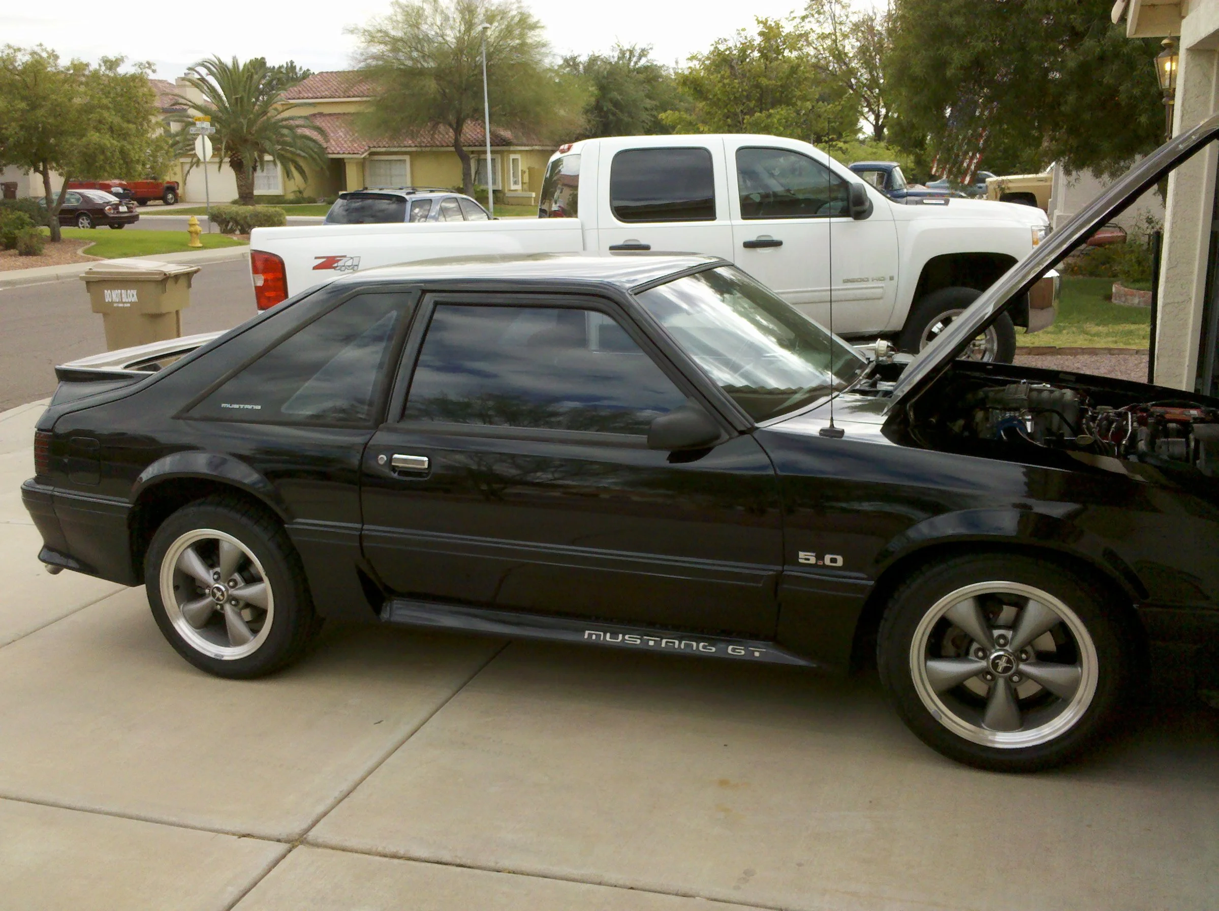

First post, pulled a ton of info here, hoping someone may be able to assist:
Cranks - No start condition. I've used all the flowcharts I can find and still no go.
Here is where it currently stands:
90 hatch, 347 with afrs, N/A, aftermarket intake, stock fuel system, comp valve train, 5 speed car
Combo has been together for about 6 years and has been bullet proof, until last saturday. Here is what works:
FP - right at 39lbs and 43-45 while cranking
TPS - .96 V closed almost 5v WOT
Spark - At coil, at plugs, all of them
Replaced TFI and distributor
ECU seems to start up and go through checks
Compression approx 150lbs on all cylinders
Plugs wet with fuel
No fire with starting fluid trick
ECC relay is firing, can feel by hand and fuel system primes
Fuel pump relay primes and shuts off like normal
tried 1/4 throttle, full throttle, sometimes back fire as though timing is off
Here is what happened - 2nd gear about 25 miles an hour, coughed and then quit. Immediately up trying to restart, motor sounded as though it was fighting timing( as though 180*out etc.)
My immediate thought - oh
, chewed the dist gear. Popped off cap and confirmed no slack and rotated while cranking motor.
My dad and I are tying to make the power tour for first time. Curise works and I just charged AC - 37* - I am so ready to go then it quit.
Please help me not take the diesel truck instead on the power tour
