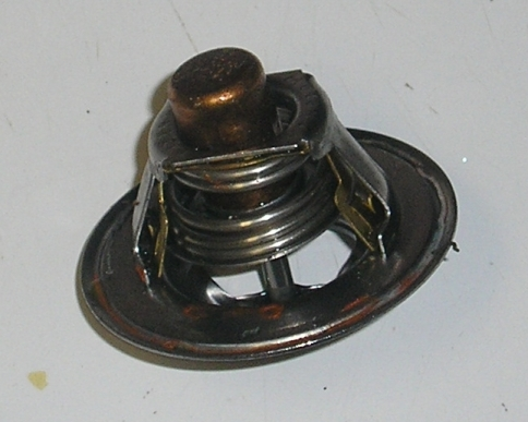

this is brand new. could this have something to do with the malfunctioning thermo

Other issue is the radiater is moving water right at start up. I dont believe it should be doing that? I let it get to operating temp and stuck a thermo in the radiater and it read 150. Factory gauge is reading slightly above the 130 bar. So it would seem the brand new thermo for 12.00 (a 180) stays open or is not working right. I never pick up two gaskets. Just tested two 195's and they both work.
Also on cold start up, it idles smooth, but after reaching operating temp it starts to idle kind of rough. Like it wants to die and the tac is real bouncey.

Well found out why I was only runing at 150 on the temp.
