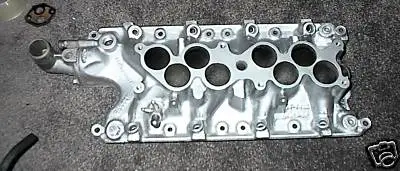

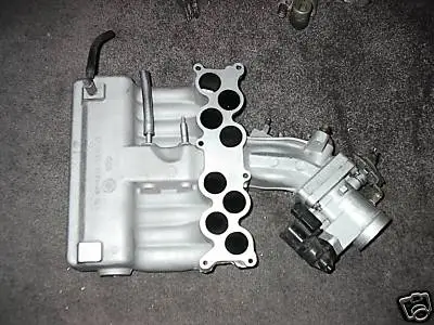

Yeah its a 94-95 Cobra manifold,here is some pics of the upper and lower.
So the upper will work ok with this lower,if it has no EGR passage,but the lower has?
even if i'm not deleting my EGR stuff?

That port is just a heat riser, it's not the EGR on the 94-95 maifolds at least. It's supposed to help heat the intake and make the fuel vaporize better, aid combustion, etc... on a cold motor to reduce emissions I believe.
No, it is an EGR port, plain and simple. Like I said, they used that lower for many years in many different applications, not just the 94/95 Cobras. So, rather than retool all their molds, they chose to use the same basic lower intake and change the upper to suit the needs as per situation.
Since our cars get EGR gasses from the passenger header, there was no need to run the internal EGR further than the lower intake. If you install a Fox Cobra upper intake on that lower, the internal EGR will function exactly the same.
And yes Jim, the EGR will function the same either way. When you slap the upper on there, it will block that port in the lower and it won't even be an issue at all. Just put all the EGR stuff from your old intake onto this Cobra intake and you're all set! :nice:
This information is all correct, I wasn't trying to say any different. However on our style of manifold, this port serves to let hot exhaust gases 'brew' in the lower intake, heating up the whole manifold. Granted, the heat will transfer eventually between the heads and the lower even with the ports blocked off, but it takes more time. I blocked mine the last time I had it apart, and the upper stays about 15* or so cooler, according to my hand thermometer (probably less accurate than a butt dyno). Just an opinion. :nice:
